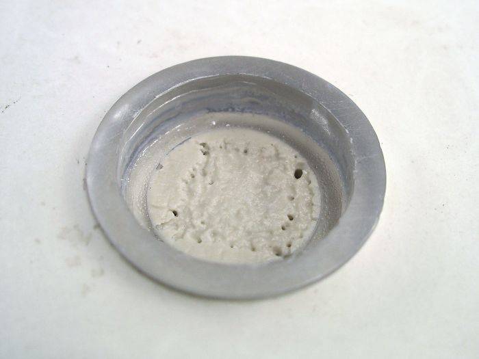

Hi, I have been working on a formicarium (terrarium for ants) design for a while now, and have been battling a problem with what I think is corrosion of gypsum cement. This design has a hydration system that basically uses capillary action to wick water up a sponge and into gypsum cement (Hydrostone to be exact). What happens, is in just a matter of hours, the sponge or any other material litterally eats its way into the Hydrostone, and sometimes I actually find pin holes all the way through 1/4 inch of it.
This is what this particular formicarium looks like. This is the one mostly affected by this problem.
This is what the top (floor of the top container) looks like after eight hours or so.

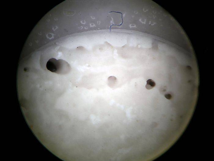

This is the bottom of the top container (directly below the hole in the first picture). This is what actually sits on the sponge.
This is the bottom magnified.
Hydrostone is made up of >95% Plaster of Paris, <5% Portland Cement, and <5% Crystalline Silica.
The MSDS can be found here: http://www.usg.com/content/dam/USG_...ydro-stone-gypsum-cement-msds-en-52140052.pdf
The water used is typical bottled water.
Quite a few people I know have suggested this could be a pH issue causing calcium to dissolve.
If anyone can tell me what might be happening here, and if there's a way to stop it, it would be much appreciated.
Not a pH problem. Plaster of Paris dissolves in water.
The water is just to control humidity for the ants? Not an actual source of drinking water? If that's the case, saturate the water in the tray underneath with broken hydrostone plates, or plaster shards. No concentration gradient in the wick, no transport of dissolved gypsum down the wick to the water tray.
Interesting. The water actually serves both functions. The particular type of ants that this specific formicarium is for, are called Leaf Cutter Ants. They garden a type of fungus that requires near 100% humidity at all times.
For the sake of not complicating the post too much, I didn't mention that I actually tried something much like what you just suggested, except I was doing it in hopes to balance the pH. I poured a 1/8 inch layer of Hydrostone in the bottom of the water tank, which seemed to have solved the problem at first. The only thing is when I did this, because the tubes that support the sponge were so close to the bottoms of the tanks, this left a very small crack to allow the water to flow through to the sponge, that it slowed down the rate of absorption. Once I modified it to allow another 1/8 inch of clearance again, the rate of absorption was back up, and the holes started to form again. I'll still try exactly what you mentioned, but do you think maybe actually pouring some Hydrostone while still in powder form into the water would do the same? Also, wouldn't it be possible to put water filters on the ends of the tube supporting the sponge so that it would only have to saturate the water in the sponge?

It's IN solution --- no filter for that. The sponge/wick is going to be a substrate for the fungus isn't it, so you have to have something between it and the garden. Any "Hydrostone" mixes that are higher in cement concentrations?

Up until now I thought Hydrostone was mostly concrete, but now that I know it's not, concrete does sound like an option. Terra cotta, or other clay-based materials would work great, except they either need to be fired, or if they're already fired, they would need to be cut and fit into the containers, which would not be easy. However, a bisque or unglazed ceramic tile was actually my next best solution; I just wanted to make sure I wasn't overlooking something about the Hydrostone that could be easily fixed. At this point, it doesn't sound like it can be, so I probably will go with the ceramic tile, but first I do want to explore the concrete idea.
