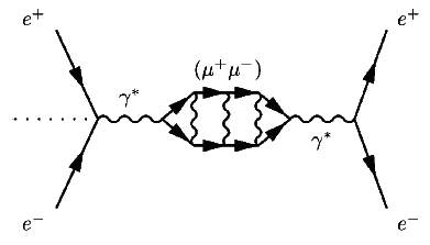

Dear nrqed, I know the diagram, I am curious about how to add the details of the "box" in the amplitude?

I am a bit confused why you initially mentioned e e+ going to two gammas, I don't see this in the diagram.
For the box, it depends if the

Hi,
Ah ok. I am confused why you mentioned e- e+ going to two photons in your original post, this does not occur in your diagram.
Well, it depends on whether the muon and antimuon are produced with a small relative speed or not. If it is large, you can just do the usual Feynman diagram expansion. But at small speeds, the muon and antimuon can interact for a long time, being essentially bound through the Coulomb interaction. In that case, one must sum up an infinite number of Coulomb photon exchanges between the two. This can be done. I don't know if my PhD thesis is available online easily (Patrick Labelle, Cornell University, 1994) but I do it there. Or look for old papers by Peter Lepage (on positronium) or my Toichiro Kinoshita (on muonium)

Now that I think of it, the easiest reference to find is a paper on pionium by Labelle and Buckley. It is on the archives. I am pretty sure we give the formula needed in that paper.
