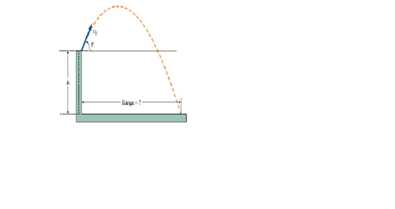

Formula for time of flight in projectile motion is 2usin theta/g but I think it is only applicable for when object is launched from ground i.e in the case below
But when it is launched from certain height this formula is no longer in use.

I think ,you are right.I have done some calculations.Check whether I am correct.
I have divided the trajectory into two parts.
Now

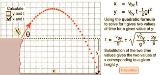

S sub y (distance covered in y direction)=V0 sin theta T +1/2 g T^2
h=V0 sin theta T+1/2 g T^2
where T =time of flight
Now we can solve for T as other variables are given.The above equation forms quadratic equation.so we will gwt two values for T one of which will be negative ,as time can never be negative we will take the other one(positive value of T)
(I have taken downward direction to be positive)
And S sub x=(distance covered in x direction)=V0 cos theta t
If we put t=T in the equation we get
Vo cos theta T
which is nothing but Range.

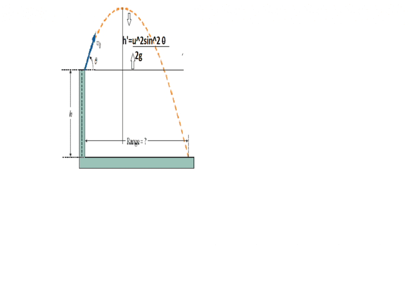

For maximum height
I have again divided the trajectory in two parts
Now we can see the maximum height=h+h'
where h' is same as in case of object projected from horizontal surface and lands on the same horizontal surface.And h is given,hence we can find maximum height.
