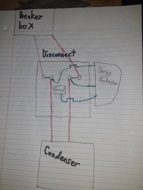

There is a straight path for electricity to travel from my breaker box to my disconnect to my condenser without going through a surge protector. How does the surge protector on my disconnect of my condenser protect my condenser?
I recently installed a surge protector to the disconnect for the condenser of my straight air-conditioner. I installed the surge protector to the disconnect for my condenser in exactly the way that the instructions with the surge protector instructed me to install the surge protector. I don't understand how the surge protector can protect my condenser from a surge.
The photograph above this text is a drawing or diagram I made of the electrical set up of my disconnect and my surge protector. As the drawing shows, there are four bolts holding wires in my disconnect. I made little circles represent the bolts holding the wires in my disconnect. The first bolt is the circle on the far left. The second bolt is the circle that is second from the left. The third bolt is the circle that is third from the left. The fourth bolt is the circle to the far right. When the disconnect is plugged in, a metal bar (which is a conductor of electricity) connects the first bolt to the second bolt, and another metal bar (which is also a conductor) connects the third bolt to the fourth bolt. The first wire of the surge protector goes to the second bolt. The second bolt merely holds the wire of the surge protector to the wire of the first leg of power going to the condenser. The third bolt merely holds the wire of the surge protector to the wire of the second leg of power going to the condenser.
I can think of two ways that a surge of electricity could go through my breaker box to the disconnect of my condenser: 1# a surge of electricity due to a lightning strike and 2# a surge of electricity due to a microwave or other electronic device or an appliance (such as the refrigerator) turning on.
If the surge protector was wired up so that current had to go through the surge protector to get to my condenser, I could understand how the surge protector would protect my condenser from a surge of electricity. If a surge of electricity went through my breaker box to my disconnect, I don't see any reason why the current would not bypass the surge protector and go straight to my condenser.
Since a surge of electricity from the breaker box would have a straight path from the breaker box to my disconnect to the condenser (without ever going through the surge protector), how would my surge protector on the disconnect for my condenser protect my condenser from a surge of electricity?
It looks like it is connected correctly; it is in parallel with the AC Mains feed and the Earth Ground connection. Presumably there are 3 MOVs or other transient clamp devices inside the unit, one differentially between H and N and the other two between H-Gnd and N-Gnd. That offers protection from differential and common-mode Surge transients.
And it is correctly placed *after* the breaker box, so that if the Surge is big enough and the protection clamps sink currents over the rating of the breakers in that panel, the breakers will open.
Do you have the datasheet for the Surge protection module? What are its voltage, current and power-energy ratings?

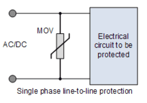

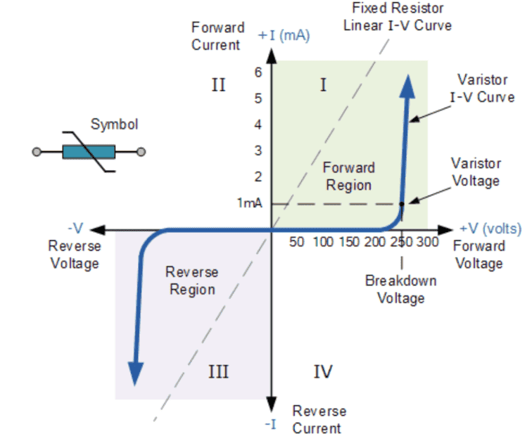

There are different kinds of surge protectors. One of them is called a MOV, Metal Oxide Variable Resitor (or Varistor). It is simple an inexpensive.
From:
https://www.electronics-tutorials.ws/resistor/varistor.html
As such varistors are used in sensitive electronic circuits to ensure that if the voltage does suddenly exceeds a predetermined value, the varistor will effectively become a short circuit to protect the circuit that it shunts from excessive voltage as they are able to withstand peak currents of hundreds of amperes.
A disadvantage is that a surge can be so severe, that it burns the MOV out. If that happens, it no longer protects and must be replaced. But there is no indication telling you that it must be replaced. If you don't know, it can sit there year after year, not protecting anything.
Do you have the datasheet for the Surge protection module? What are its voltage, current and power ratings?

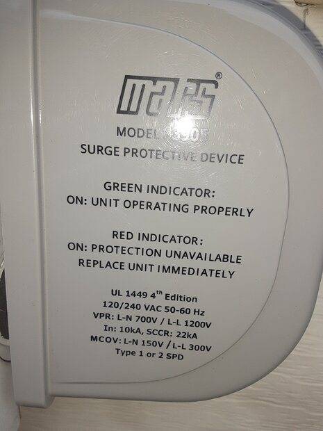

I don't have the datasheet right now. I am at work, so I cannot look at the surge protector right now. I think it might have the voltage, current, and power ratings on the outside of the surge protector.

My surge protector has a green light that lights up when the surge protector is functional and still protecting the condenser. If my surge protector gets burned out so that the surge protector no longer protects, then the surge protector lights up with a red light.
Interesting. When you get a chance, please post a link to the datasheet. It will be interesting to see what they have inside that let's them show a status like that. Presumably more than just simple MOVs.

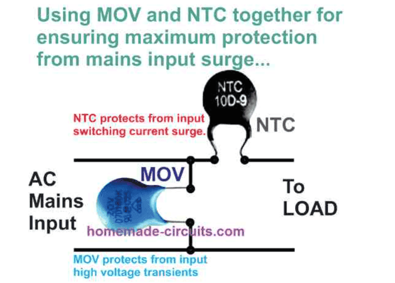

I neglected to say that there is a second kind of surge -- the current surge when turning on electrical devices, including the motor in a HVAC compressor. Here's a circuit to provide both types of protection.
NTC stands for Negative Temperature Coefficient, thermistors.
Note that even that two way protector still has two wires in and two wires out.
All circuits can be made more elaborate to include a function like an indicator light. The trick it to to that in a way that does not compromise the basic protection. Just by looking at the plastic enclosure and the green LED, there is no certain way to say what is inside that surge protector, how effective it is or how dependable it is.

The surge suppressor you have has three MOV's; one across the two power lines (L1 to L2), and one from each power line to Ground.
