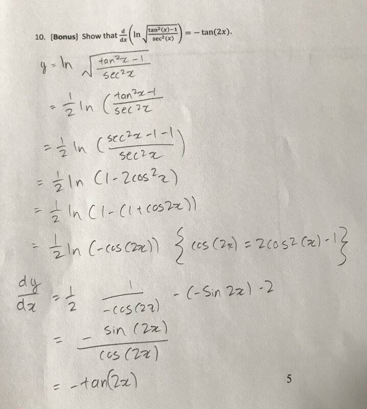

I believed I've proved it right, but can someone confirm?
n/a
I believe it is correct, but note that
$$(\tan^2 x -1)/\sec^2 x = (\tan^2 x -1) \cos^2 x = \sin^2 x - \cos^2 x = - \cos(2x)$$
so you could have been a little faster.
