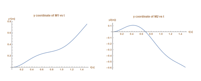

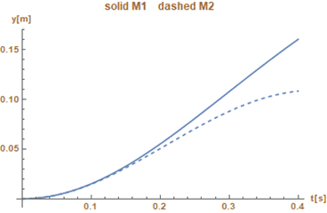

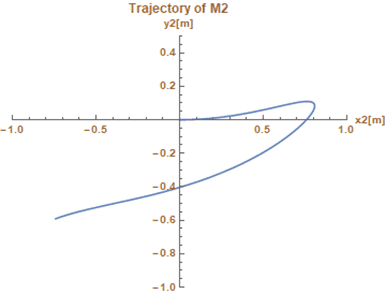

If ##y_2## is the height above the floor of the swinging mass, then does the symbol ##V_v## equal ##\dot y_2##? If so, then initially wouldn't we have $$T-mg= m \ddot y_2 = m\frac{dV_v}{dt} \,\,\,\,?$$
Jahnavi said:
Good point .
But isn't it interesting that net force on the right mass is upwards , yet it moves downwards ?
Does it really move downwards initially?
It seems I am still unsure of how things are moving .
I thought right mass moves rightwards and downwards .
If left mass moves upwards shouldn't right move downwards ?
