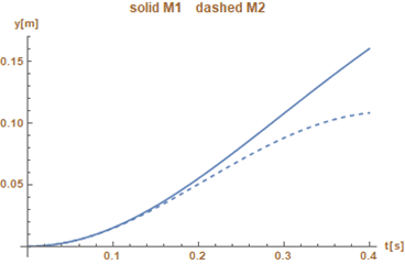

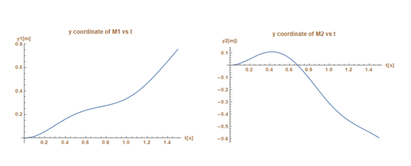

Yes. I used Mathematica to get a numerical solution to the equations of motion. I let the initial length on both sides be 1 m and let the initial speed of m2 be 2.5 m/s. Here is the trajectory of m2 for the first 1.5 seconds. The origin is at the initial position of m2. You can see how m2 rises upward before starting its descent.Chestermiller said:I agree. Certainly the length of string on the left will be shorter than the length of string on the right.
Here's a closer look at the y-coordinates near the initial time. For about the first tenth of a second, the y coordinates are almost the same. But then you can see how y2 falls behind y1.

I love it! Your modeling analysis was spot in.TSny said:Yes. I used Mathematica to get a numerical solution to the equations of motion. I let the initial length on both sides be 1 m and let the initial speed of m2 be 2.5 m/s. Here is the trajectory of m2 for the first 1.5 seconds. The origin is at the initial position of m2. You can see how m2 rises upward before starting its descent.
https://www.physicsforums.com/attachments/210591Here are plots of just the y-coordinate of each mass as a function of time
This has been a really fun problem to work on.
