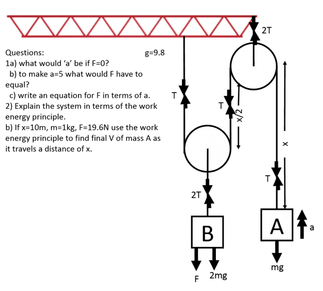

Hi, everyone.
my teacher stuck me with these questions and i am need of a little help answering question 2.
here's my answers to question 1 first.
1a) a=0, as system would be in equilibrium when F=0
b) F=5mgN, as for a=5m/s the acceleration of B has to equal 2.5m/s and as its in equilibrium F has just got to equal m*a which is 2.5*2mg=5mgN
c) F=mga
i think my answers are right but if I am making a simple mistake let me know.
now my attempts at 2.
2a) first, B has to x/2 above the ground for the full system to work so original potential energy is 2mgx/2=mgx assuming A starts on the ground. now its the following kenetic energy bits that are confusing me because there will be two different V's one for A and one for B. VA = 2VB so assuming no energy gets lost to heat via friction whatever all of the gravitational energy plus energy input from F has to turn into kinetic energy so I am thinking.
mgx + Fx = 1/2mVA 2 + mVB 2
which kind of works if your given enough information. but part B doesn't i don't think.
2b) substituting values into my answer to 2a
98 + 196 = 1/2[ VA 2 + 2VB 2 ]
so VA 2 + 2VB 2 = 588N
and VA = 2VB
so with further manipulation i get VA = 19.8m/s
but using logic from question 1. if F=19.6 and B has a mass of 2kg, the acceleration of B = 9.8m/s 2 therefore acceleration of A = 19.6m/s 2 and then using SUVAT.
s=10m u=0 v=? a=19.6 m/s 2
v 2 = u 2 +2as
v = 23.2m/s
which is different. iv tried multiple times and i can't figure out what I am doing wrong. I am pretty sure its the WEP part not the SUVAT part as I am better at that but i do not know.
please help.

Your answer to 1b) is wrong.
Write out the full force/acceleration equations for the two masses, including T as a common unknown.
Taking shortcuts often leads to errors.
okay, here i go.
For mass A: T-mg = 5m =X2=> 2T-2mg = 10m
For mass B: F+2mg-2T= -2.5(2m) = -5m
adding the two equations:
F=5m
is that correct?

Check your signs in the mass B equation. Think which way the acceleration is.
i have taken up to be my positive direction so a is positive for A and negative for B.
is that not right?
is that not right?
The left hand side of your mass B equation takes down to be positive.
okay then. would that them make F=15m ?
Yes. But you should include units since the 15 is not dimensionless.
Does that then make the answer to 1c) F=3ma N ?
Yes, but this time you should leave out the units. That's because m is a mass and a an aceleration in unspecified units, so it's just F=3ma.
Do you mean it has to start x/2 above the ground? It certainly needs to be at least that.
You can't say what the original PE is unless you define a zero level. The loss in PE by B will be mgx.
How far does F move?
assume the zero lvl is at the base of mass A and B is exactly X/2 above the ground.
the PE of the entire system is then: 2mgx/2 = mgx
the energy by F is: Fx/2
KE of A afterwards is 1/2*m*va2
KE of B afterwards is 1/2*2m*(vb/2)2 = m*(vb/2)2
as vb = 1/2va
KE of B can also be written as: m*(va/4)2 = mva2/16
so the equation should be:
mgx + Fx/2 = 1/2mva2 + mva2/16
which can be simplified to:
mgx + Fx/2 = 9/16mv2
is that right or am i missing somthing?
Why vb/2?
i was thinking as it is half Va but then i did it again. does that then make the end, mgx + Fx/2 = 3/4mv2 is that right?
Yes.
for part 2b I am still getting different answers depending on which method i use.
if F=3ma, 19.6=3(1)a, a=6.53.
using v2 = u2+2as
v2 = 2(6.53)(10) = 130.67
so, v= 11.43 m/s
but if we use mgx + Fx/2 = 3/4mv2
1(9.8)(10) + 19.6(10/2) = 3/4(1)v2
196 = 3/4v2
v2=261.33
v = 16.17 m/s
whats wrong?

I missed another error in the OP.
Think again about the total change in PE.
would mass A also gain PE
so mgx + Fx/2 = 3/4mv2 + mgx
which would leave you with Fx/2 = 3/4mv2
19.6(10)/2 = 3/4(1)v2
98 = 3/4v2
v2 = 130.67
v = 11.43
which is the same as the suvat and forces one. :) we did it

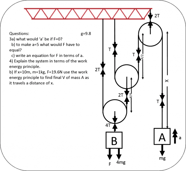

what iv noticed is that the questions are the same, so this is basically a check before i hand in my answers as hopefully ill get them right.
iv also noticed B will never be as low as A due to the ropes making a infinite series upto 1 or x but this time B can only move x/4 if A is on the ground.
okay question time.
3a) a = 0 as in equilibrium again
b) do c) first and put a = 5 gives F = 25m N
c) F+4mg-4T = 4ma/4 = ma
T-mg = ma ==> 4T-4mg = 4ma
so F = 5ma
4) 4mgx/4 + Fx/4 = 1/2(4m)(v/4)2 + 1/2mv2 + mgx
mgx + Fx/4 = mv2/8 + 1/2 mv2 + mgx
Fx/4 = 5/8 mv2
4b) 19.6(10)/4 = 5/8(1)v2
49 = 5/8v2
v2 = 78.4
v = 8.85 m/s

Looks right.
he had more. just checking again for 5 and need help on 6.
5) we have an equation to find V when B is there.
Fx/4 = 5/8mv2
we can then work out an equation for when B isn't there:
Fx/4 = 1/2mv2 + mgx
now F has to be greater than the weight of B as the question says so let F = 100N, m=1KG, and x = 10m.
with B:

6) now as its the method with B i want to assume B changes as P increases so that the system remains in equalibrium without F as it did between questions 1-2 and 3-4.
if that's the case i worked out the mass of B = 2p-1
it would also have less to travel, x/2p-1 m i think?
so would it look something like:
2p-1mgx/2p-1 + Fx/2p-1 = 1/2m(v/2p-1)2 + 1/2mv2 + mgx
mgx + Fx/2p-1 = 1/2mv2/22p-2 + 1/2mv2 + mgx
Fx/2p-1 = mv2/22p-1 + 1/2mv2
Fx/2p-1 = (2+22p-1)(mv2)/22p
now that doesn't seem right at all so i would for you to check it over and correct me please haha
thanks.
I'm not sure how to interpret 5. You have compared a given F, with and without B. But maybe they intend you compare some F in conjunction with B, for a total force of F+mBg, with just a force F'=F+mBg.
Does your general equation for part 6 produce the right answers for p=2, 3?
i think its removing the weight of B aswell. and my equation gave me 12.52 m/s instead of 11.43 m/s for question 2 values. where am i going wrong?
Take your working for part 6, substitute p=2 everywhere, and compare it with your previous working for the p=2 case.
Fx/22-1 = (2+22(2)-1)mv2/22(2)
Fx/2 = 10/16mv2 = 5/8mv2
which isn't the same as
Fx/2 = 3/4mv2
