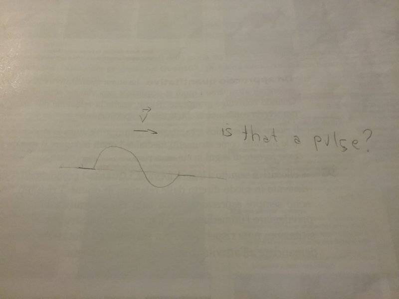

What are the difference between them?
What is that one in the photo?
It is a damped sine-wave pulse that appears to have been gated. A sequence of them would be a pulse train. The wave is about shape.
In terms of daily life, waves are something which are waving and are not necessarily periodic, e.g. (real) water waves, sound waves, and EM waves. Mathematically, waves are the solutions of the wave equation.
Pulses are usually used to describe a propagating disturbance but localized in space at a given instant of time. A train of pulses (rather than a train of waves) are actually a superposition of many waves, therefore it also satisfies the wave equation, and with regard to the above paragraph it can also be called a wave.

So non-sinousoidal tone pulses are okay like the distorted waveform in the picture. My favorite pulses are always made of a superposition of waves of various frequencies and amplitudes as a Fourier series.
I don't know what you want to say there.

I was thinking about a comment about sinusoidal wave shape not being a pulse.
As I have suggested before, that the term "pulse" is most commonly used to describe a propagating disturbance which is localized in space in a given instant of time. This is what I believe as what most people, in particular scientists or engineers working in a field relevant to this term, have in their mind. So, a pulse does not seem to have been well-defined to refer to a certain distinct physical phenomena, but it's a more convenient term to use to distinguish it from the continuous type of waves.
Following this, a continuous stationary sinusoidal function wouldn't normally be called a pulse.
