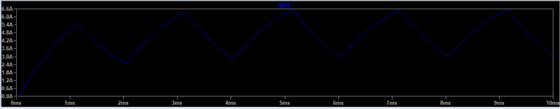

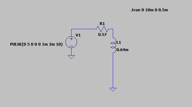

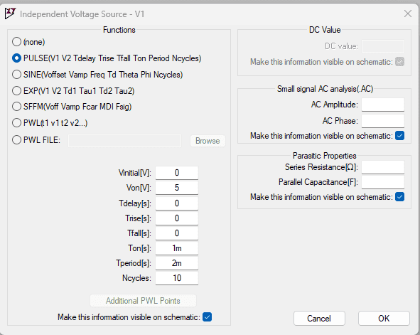

I want to check the inductor current as the PWM voltage source duty varies from 0% to 100% duty.
For any PWM duty, it will take a number of cycles to settle to a new average current, so it is probably best to stack several plots on the one graph. Each plot for a different DC%.
To do that, I would .PARAMeterise the duty, then use a .STEP to sweep through a number of values.
The average current, for the cycle at the end of each sweep, could be .MEASured and recorded in the log file.
Attached is an example.

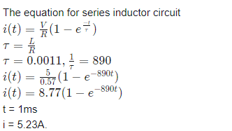

I am not sure why my results are not matching with circuit in post3
For t=2ms i used the below equation
But the answer does not match at t=2ms it is around 2.4A. I am really confused not able to solve basic circuits.
First, ignore the ripple.
Average the voltage or current over one full cycle.
For 100% duty cycle; duty = 1.00 ; I(L1) = V1 / R1;
For any other duty, averaged over each full cycle;
Vd = duty * V1;
Id(L1) = duty * V1 / R1.
