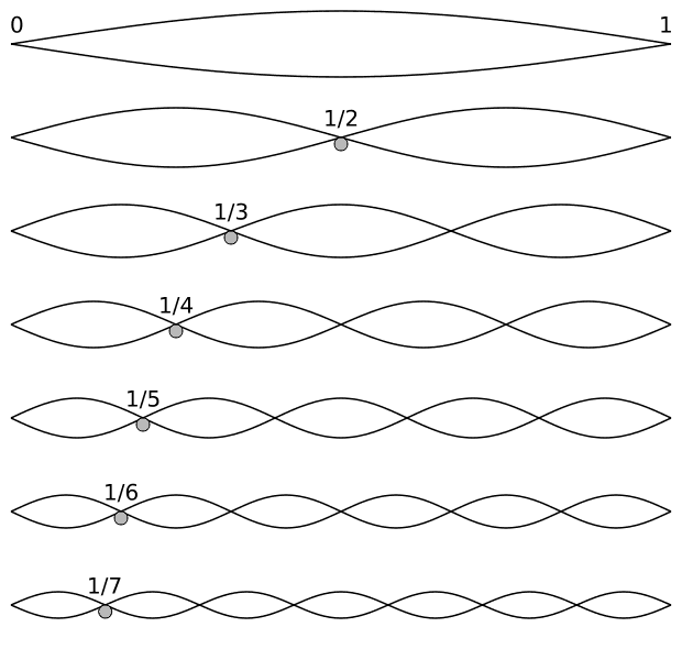

How does energy become quantized in an infinite potential well??
How do the harmonics of a finite string become quantized?

As the frequencies of a string in a guitar [tex]E_n = h v_n = n h v[/tex]
For this aspect, Pythagoras was the first to study a problem of QM mechanics.
