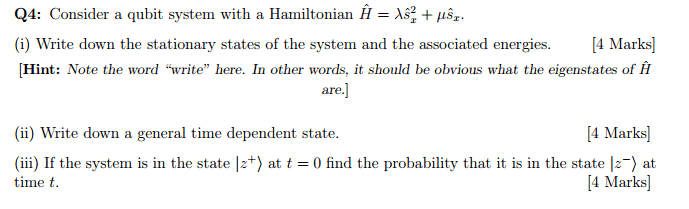

Qubit system, time dependent states.
12 replies · 3K views
Lengalicious
162
See attachment
(i) [tex]|\Psi(t)_{1}>=e^{{-itE_{1}/\hbar}}\frac{1}{\sqrt{2}}(|z^{+}>+|z^{-}>)[/tex]
[tex]|\Psi(t)_{2}>=e^{{-itE_{2}/\hbar}}\frac{1}{\sqrt{2}}(|z^{+}>-|z^{-}>)[/tex]
where [tex]E_{1}=\lambda\frac{\hbar^{2}}{4}+\mu\frac{\hbar}{2}[/tex]
[tex]E_{2}=\lambda\frac{\hbar^{2}}{4}-\mu\frac{\hbar}{2}[/tex]
(ii) [tex]|\Psi(t)>=\sum_{i}c_{i}(0)e^{{-itE_{i}/\hbar}}|\Psi_{i}>[/tex]
(iii) [tex]|<\psi(t)_{2}|\psi(0)_{1}>|^{2}=[/tex]
[tex]|(e^{it(\lambda\hbar^{2}/4-\mu\hbar/2)/\hbar}<z^{-}|)^{*}(|z^{+}>)|^{2}=0[/tex]
I feel like I'm doing something really wrong could someone check over my attempt please and guide me in the right direction if I'm doing it wrong.

Part (i) looks good. The stationary states are clearly ##|x^+\rangle## and ##|x^-\rangle## and these can be expressed in terms of ##|z^+\rangle## and ##|z^-\rangle## as you have done.
Some people would not include the time dependent exponential factors when writing the stationary states. The stationary states are often defined as solutions of the time independent Schrödinger equation, and so the stationary states are also time independent. The corresponding solutions to the full time dependent Schrödinger equation are then the stationary states multiplied by the exponential time dependent factors. Not a big deal in my opinion.
Part (ii) looks good. I would change the notation to [tex]|\Psi(t)>=\sum_{i}c_{i}\; e^{{-itE_{i}/\hbar}}|\Psi(0)_{i}>[/tex] This is the same as just writing ##|\Psi(t)\rangle = c_1 e^{{-itE_{1}/\hbar}}|x^+\rangle + c_2 e^{{-itE_{2}/\hbar}}|x^-\rangle##
You might want to write this out explicitly in terms of ##|z^+\rangle## and ##|z^-\rangle##.
This is not correct. You want "the probability that the state ##|\Psi(t) \rangle## at time ##t## is in the state ##|z^- \rangle##".
For practice, suppose you had a state that at time ##t## was given by ##|\phi(t)\rangle = .6|z^+\rangle + .8|z^-\rangle##.
What is the probability that ##|\phi(t)\rangle## is in the state ##|z^-\rangle##?

Can you write the state ##|\Psi(t)\rangle## as
##|\Psi(t)\rangle = a_1(t)|z^+\rangle + a_2(t)|z^-\rangle##
where ##a_1(t)## and ##a_2(t)## are certain time dependent coefficients?

No, this isn't correct. The states that evolve with simple exponential time factors are the eigenstates of the Hamitonian: ##|x^+\rangle## and ##|x^- \rangle##. So, the correct expression is
##|\Psi(t)\rangle = c_1 e^{{-itE_{1}/\hbar}}|x^+\rangle + c_2 e^{{-itE_{2}/\hbar}}|x^-\rangle##.
One approach is to express the x-states in this expression in terms of the z-states (which I think is what you did in your first post when you had expressions for ##|\Psi_1\rangle## and ##|\Psi_2\rangle##) . Then, if you collect together all of the ##|z^- \rangle## terms, you can just read off the probability amplitude for ##|\Psi(t)\rangle## to be ##|z^-\rangle##.
Another approach is to leave ##|\Psi(t)\rangle## in terms of the x-sates and form the probability ##| \langle z^-|\Psi(t)\rangle|^2##

Ok you have helped plenty and I think I can now do this but could you just explain the significance in question iii) where it says "If the system is in state |z+> at t=0", surely this is irelevant to answering the question as I'm just trying to find the probability of finding the time evolved state (which is written in Q1/Q2) within |z->
When you write the expression
You will need to choose the constants ##c_1## and ##c_2## so that the state will be |z+> at time t = 0.
