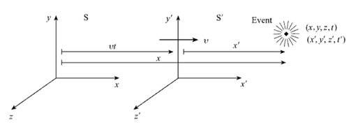

  • #31
Chenkel said:
##t' = \gamma{t}## and
##t = \gamma{t'}##
Notice the first equation is used in the Lorentz transformation and the 2nd equation is used in the inverse Lorentz transformation.
You can i.e. derive the first equation also with the inverse Lorentz transformation. It is only a little bit more complicated.
Inverse LT:
##x=\gamma(x'+vt') \ \ \ \ \ (1)##
##t=\gamma(t'+vx'/c^2) \ \ \ \ \ (2)##
The clock is at rest in the unprimed frame at ##x=0##.
With equation (1) follows:
##\require{color} 0=\gamma(x'+vt') \ \ \ \ \ (3)##
To eliminate ##x'## in equation (3), I solve equation (2) for ##x'##...
##t=\gamma(t'+vx'/c^2)##
##{t \over \gamma}-t' = vx'/c^2##
##x'=\color{blue}{c^2 \over v}({t\over \gamma}-t')\color{black} \ \ \ \ \ (4)##
... and put the right side of equation (4) for ##x'## into equation (3):
##0=\gamma(\color{blue}{c^2 \over v}({t\over \gamma}-t')\color{black}+vt')##
##0={c^2 \over v}({t\over \gamma}-t')+vt'##
##0={c^2t\over \gamma v}-t'{c^2 \over v}+vt'##
##t= {\gamma v\over c^2 }({c^2 \over v} -v)t'##
##t= \gamma(1-{v^2\over c^2})t'##
$$t' = \gamma{t} \ \ \ \ \ (\text{condition:}\ x=0)$$

Nugatory said:
Given the difficulty you are having understanding this stuff, you might want to consider the possibility that the way you’re imagining what’s going on is part of the problem….
“An observer at rest with respect to an IRF recording events” can only record the events that happen at one place, where the observer is: these are the events with x-coordinate equal to zero, forming a vertical line through the origin.
It is possible to think in terms of observers recording events, but you need more observers. Taylor and Wheeler (“Spacetime Physics”) take this approach: we imagine that the entire universe is full of observers stationed one meter apart in a grid, at rest relative to one another, and carrying synchronized clocks. Whenever something happens, the one at that spot makes a note on a slip of paper, something like “I am the observer at x=10,y=0,z=0. This spaceship passed right where I am when my clock read 12:55 PM”. After our thought experiment is done we gather all these slips of paper and use them to reconstruct what happened according to the frame in which they were all at rest. We’ll call this the unprimed frame.
Now suppose that we have another such flock of observers, also all at rest relative to one another and carrying synchronized clocks but all moving relative to our first group. We’ll call the frame in which they are at rest the primed frame.
The Lorentz transformations let me calculate, from all the notes written by the unprimed frame observers, what the various primed-frame observers will have written down. The inverse transformations go the other way, they let me calculate the unprimed-frame results from the primed-frame ones.
So if the frames are moving with a relative velocity of 86.6 percent the speed of light (gamma factor of 2) then an event at x=1 y=0, and z=0, and t=20 seconds will be recorded in the primed frame at t' = 2*(20 -.866*1) = 38.268 and x'= 2*(1-.866*20) = -32.64 light seconds
The event of recording an event at x'=-32.64, y' = 0, z' = 0, and t' = 38.268 seconds in the primed frame will happen in the unprimed frame at t=2(38.268 + .866*(-32.64)) = 20.00352
And x=2(-32.64 + .866*38.268) = 1.000176
We got roughly the same value for t and x as when we started so this makes some sense to me.

Chenkel said:
I just plugged the Lorentz transformation into the inverse Lorentz transformation algebraicly and found that after simplifying x = x and t = t so the Lorentz transformation and the inverse Lorentz transformation must be true for an event in the primed frame and a corresponding event in the unprimed frame for both Lorentz transformation and inverse Lorentz transformation.
You got it!
Now, if you want your next challenge, try deriving the time dilation formula ##\Delta T' = \Delta T/\gamma## for when a spaceship leaves earth travelling at speed ##v## - when one year has passed on earth, how much time has passed on the spaceship?
There are two relevant events:
1) Spaceship passes earth, x=0, t=0, x'=0, t'=0.
2) The spaceship is where it is after ##\Delta T## years have passed on earth: ##x=v\Delta T##, ##t=\Delta T##. This will require calculating the x' and t' coordinates of that event.
Get past that challenge and we'll have another one for you involving the symmetry of time dilation.

These are my equations:
##t' = \gamma(t - vx/c^2)##
##x=vt##
So
##t' = \gamma{(t - \frac {v^2{t}} {c^2})}##
##t' = \gamma{t(1 - \frac {v^2} {c^2})}##
##t' = t\sqrt{(1 - \frac {v^2} {c^2})}##
##t' = \frac t \gamma##
