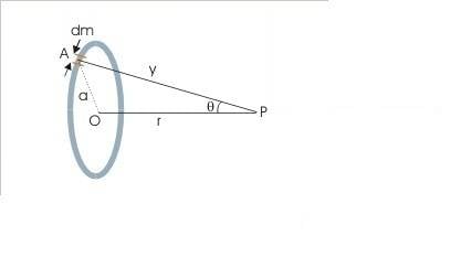

For e.g If I want to find the mass of a ring of mass M(redundant, I know) , I can do that by "summing up" infinitesimal elements of mass dm => \int {dm} from 0 to M or summing up \rho Rd\theta from 0 to 2\pi
Or if I want to find the total gravitational potential due to a ring:
I could write the small potential dV for an element dm and sum up these dV's using integration to give me the total V due to the ring.
But I want to know why this works/makes sense, mathematically.
Because I think of integration either a way to solve differential equations or as the area under a curve, and I don't understand why the area under the curve(and which curve?) would represent the total potential V or mass M

could you show how I could apply the Riemann sum for the two examples i mentioned at the end? (mass and gravitational potential)

I understood that the integral is the limiting case of a Riemann sum. But how do I set up such a sum in physics problems?
I know for a Riemann sum we need to sum up ∑f(x_i)Δx from i = 1 to ∞ and Δx ->0 turning this into an integral.
But for the two problems I'd given (finding the total mass and total gravitational potential energy) I've gotten M = ΣΔM and V = ΣGΔM/y but I have no idea how to proceed after this and set up the index on the sigma so I can turn this into an integral.

A typical scenario is:
Given: If variable_A is constant with respect to variable_B then "the answer" is (variable_A)(variable_B).
Conclude: When variable_A varies with respect to variable_B , the "total answer", as a function of variable_B, is ##\int##variable_A with respect to variable_B. example: Displacement ##d## (i.e. "distance") = velocity ##v## times times elapsed time ##t## when ##v## is constant with respect to ##t##. So when velocity ##v(t)## varies with time ##t##, displacement ##d(t) = \int_{0}^{t} v(t) dt.##
Justification by Riemann sums: Divide elapsed time up into ##N##small subintervals ##[t_0, t_0 + dt], [t_0 + dt, t_0 + 2 dt], ... ,[t0 + (N-1) dt, t0 + Ndt = t]##. On each interval ##[t0 + k\ dt, t0 + (k+1)dt]## , approximate ##v(t)## by using the constant value of ##v(t0 + k\ dt)## for that entire interval. The displacement over that interval is thus approximated by ##v(k0+\ dt) (dt)##. The total displacement is thus ##\sum_{k=1}^N v(t0+k\ dt) (dt)##, which is a Riemann sum approximating ##\int_{t0}^{t} v(t)dt##.
example: When a rod of length ##L## has constant mass density ##\rho## per unit length, total mass ##M = (\rho)(L)##.
Suppose the rod has a mass density ##\rho(x) ## per unit length that varies with the position ##x## on the rod.
Then ##M = \int_0^L \rho(x) dx##.
Justification by Riemann sums: Divide the total length ##L## of the rod up into ##N## sub-lengths ##[0,0+dx], [0+dx,0+2dx],[0+2dx,0+3dx],...,[0+(N-1)dx, 0+Ndx = L]##. Approximate the mass density ##\rho(x)## on the interval ##[0+k\ dx, 0+(k+1)dx]## by its value ##\rho(0+k\ dx)## at the left hand endpont. The approximate mass of the interval is ##\rho(0+k\ dx) (dx)##. The total mass is approximately ##\sum_{k=0}^{k=N} \rho(0+k\ dx) (dx)##, which is a Riemann sum for ##\int_{0}^{L} \rho(x) dx##.
