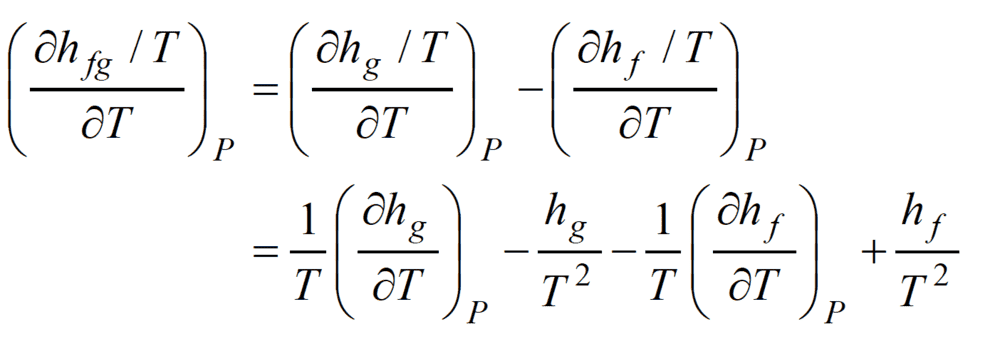

From the solution of my thermodynamics homework,
({\frac{\partial h_{fg}/T}{\partial T}})_P \\ = ({\frac{\partial h_{g}/T}{\partial T}})_P - ({\frac{\partial h_{f}/T}{\partial T}})_P = \frac{1}{T} ({\frac{\partial h_{g}}{\partial T}})_P - \frac {h_g}{T^2} - \frac{1}{T} ({\frac{\partial h_{f}}{\partial T}})_P + \frac {h_f}{T^2}
Isn't ##({\frac{\partial h_{g}/T}{\partial T}})_P = \frac {h_g}{T^2} ##?
And ##({\frac{\partial h_{f}/T}{\partial T}})_P = \frac {h_f}{T^2}##
Why is there the other two parts: ##\frac{1}{T} ({\frac{\partial h_{g}}{\partial T}})_P ## and ##- \frac{1}{T} ({\frac{\partial h_{f}}{\partial T}})_P## ?
Thank you
I am a little confused by your notation. When you write, for example, ##\left( \frac{\partial h_g /T}{\partial T} \right)_P##, do you mean ##\left[ \frac{\partial}{\partial T} \left( h_g /T \right) \right]_P##?
Also, do ##h_g## and ##h_f## have ##T## dependence? If so, then
come from the product rule for differentiation,
$$\left[ \frac{\partial}{\partial T} \left( h_g /T \right) \right]_P = h_g \left[ \frac{\partial}{\partial T} \left(\frac{1}{T} \right) \right]_P + \frac{1}{T} \left[ \frac{\partial h_g}{\partial T} \right]_P$$
