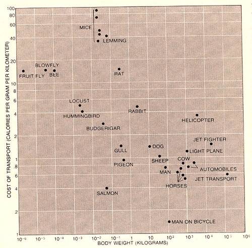

For a human, and for most animals, the energy invested in walking or running doesn't come only from overcoming internal or external friction, but from keeping on all two (or four) legs. Besides, the muscle elasticity used when running is not perfect, and some energy is lost to heat by those 'springs' that must be replaced. Simple physics equations are not going to solve your problem for the case of simple walking. However, the energy spent in some tasks may be approximated. For example, if you climb up ten stories in one minute, most of the muscular energy delivered by your body will be invested in increasing your body's potential gravitational energy. But moving onself's body with muscular power along a level surface is different...I'm adding below a diagram published in 'Scientific American', in the 70s I believe, in an article titled 'Bicycle Power'. Please note how a man on bicycle needs far less energy that a man walking...
