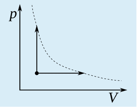

Hi every one , I have this question today :
The two arrows in the figure show two thermodynamic processes of a certain amount of ideal gas. The dashed line is a hyperbola. Which of the following statements is not true?
241473
a. The heat transfer is the same in the two processes.
b. The temperature change is the same in the two processes.
c. The change in internal energy is the same in the two processes.

No, there is a transfer of heat in both processes. What makes you think ΔT is zero? ΔP is zero in one, ΔV is zero in the other.
The question asks whether the same quantity is transferred,
One of the conditions of the case Isothermal : delta t =0

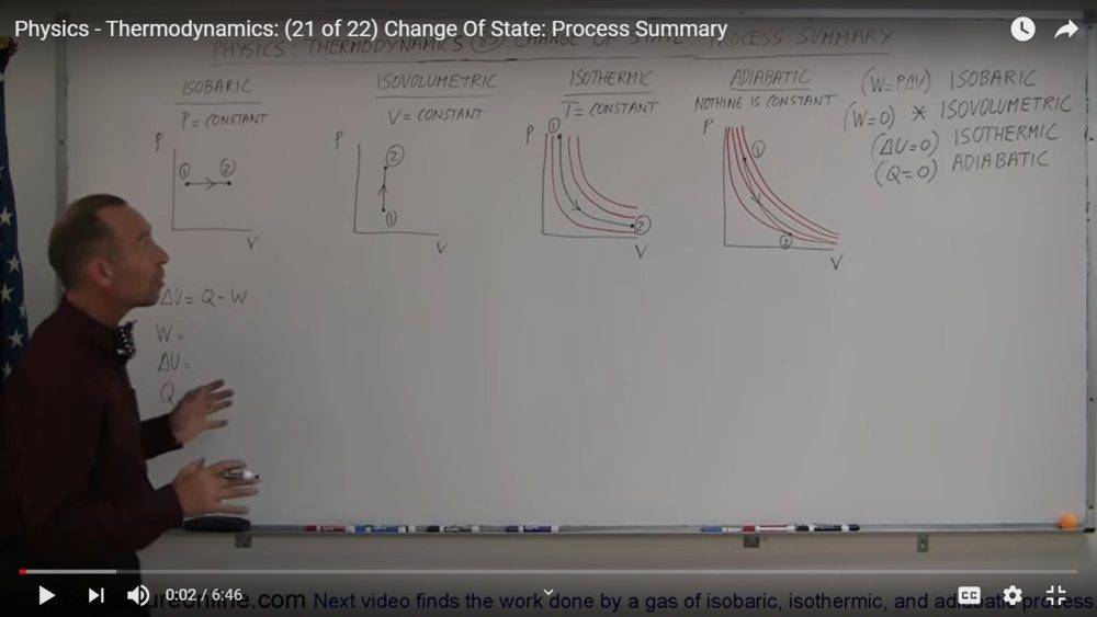

Delta T and delta U are the same in both processes. But, they are not zero.

Are you saying the delta T is zero for each of the two process paths? Or are you saying that delta T is zero between the two final states of the two processes?

Even though a is the right answer, I mark you wrong on this problem because you were unable to provide an acceptable explanation.

In that attachment, isothermal follows one of the curves. In the present problem, each process follows a straight line, one vertical, one horizontal. Neither is isothermal.
You seem to be thinking of a process that runs from one of those two final states to the other. That is not the question asked. You are asked to compare the two non isothermal processes.
