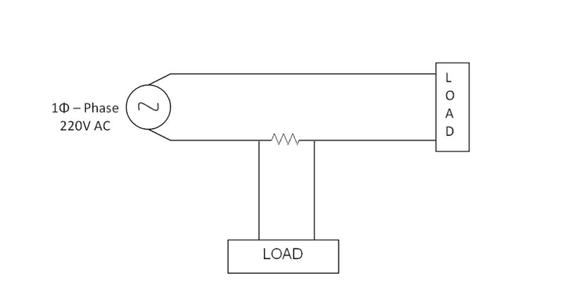

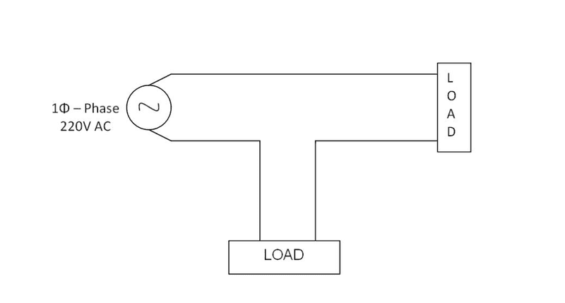

Hello guys!
I would just like to ask if this connection is possible.
Hi Xiv_wolf,
This connection is possible. It just won't do anything as you probably won't have any voltage across the load (unless the connection points are really, really, far apart, and even then you won't have much)
Worked for company that built welders using this circuit. (80 volt instead of 220 volt)
Bottom load was ammeter to measure current in (main) load.
Used copper or aluminum bus bars between power source and (main) load.
No voltage drop across leads to bottom load = no circuit = no work.
The bottom load in your picture has been short-circuited, and therefore, bypassed.

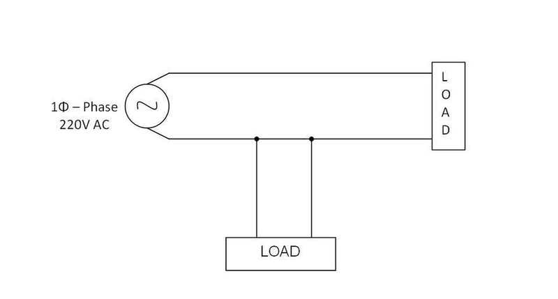

On the other hand this will work:
... but each load will only utilize a portion of the available 220V AC, such that the voltage drops across the load will add up to 220V.

The schematic shown by the OP shows no device of any type at this location. A straight line in a schematic represents a wire. For a shunt, there should be a resistor symbol at that location (between the 2 leads to the lower load).
So ... the answer is "No, you cannot make connection like 'this' and expect it to work."

The original circuit as shown gives no wire size or distance, so it can't be assumed that there is a shunt in this circuit. Without such qualifiers, there is nothing preventing a person who is building a circuit from the diagram from placing the leads to the bottom load at whatever distance they choose (even to the same exact point).
If a meter is to be connected in this fashion, then there needs to be a shunt (which has a specific, known resistance) and it should be indicated on the schematic. As shown, there are no restrictions and therefore the ammeter on the welder would show little or no current (at the very least, it would vary from one welder to the other).

You don't think it is possible to run roughly 100 amps through a foot of #8 copper wire with .000739 ohms per foot and develop more than enough voltage to make the meter movement go full scale when it's leads are hooked on a piece of said wire a foot apart?
Use of calibrated 50-millivolt shunts for measuring very high dc currents is standard practice. The voltage signal is read using a very high impedance voltmeter (insulated), so there is negligible voltage drop in the voltmeter connection. See

Not possible as drawn. The existence of a shunt (a known resistance between to points) is not indicated.

First of all, the original schematic never stated that this load was an ammeter (after all, an ammeter is typically such a minor load that it generally is considered to be no load at all). Usually, meters are indicated in diagrams as such.
Second, you'd be a fool to try to build this circuit without more information.
I never doubted that you could build a circuit in which the lower load was actually an ammeter, just that you couldn't assume that there was a known resistance between the 2 points. Even if you did only use wire (rather than an actual shunt), it would likely be of different wire gauge than the rest of the circuit and would be easily identified visually as "something other than just wire" and the OP most likely would have mentioned it.
Drawn as is, it would be assumed by most people that there is no resistance (negligible at most, definitely not a precise known amount) between those 2 points. If a resistance is part of the circuit, than it needs to be displayed (or referred to) in some way. If that was the intention of the diagram, then there is missing info.
So ... good for you for explicitly say that first. (I said it implicitly).
Lastly, taking the diagram at face-value, this connection would be considered a short-circuit. If I posted a schematic of a circuit that was fed by an AC source and flashed an LED at a rate of 2 flashes per second with several components on it and then later told you that one of the wires represented by line was actually a shunt resistor, you would ask, "How come the schematic doesn't show it?" That fact would likely change the circuit in some way. Also, if someone wanted to add an additional load (another LED) to this circuit, it would not suffice to connect it in the way that the OP showed in the original pic.
Granted, it is difficult to show everything in a schematic, but not when it comes to parts and their inter-connectivity (that's what schematics are for). Proximity of parts is whole different issue ... there are different diagrams for that (plus proximity wasn't part of the original question).
So you're right, there can be a circuit like the OP's if you have a known resistance between those two points and the bottom load is an ammeter. And, you can build one. Big deal. Get off your high horse! You are obviously one of those people that is always right (or you just like to create arguments with no real purpose ... just stir the pot). I can make this circuit do just about anything, if I start adding parts that aren't indicated on the schematic.
That's surely not what the OP was asking.
Taking the length of wire and its resistance into account is a special case, one that deals with very sensitive circuits. For the standard schematic diagram (which, without additional information, is what this is), the circuit is not valid; the lower load is short-circuited.
