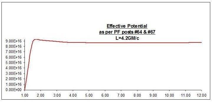

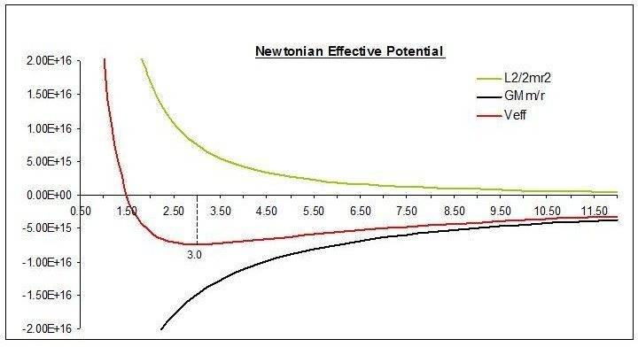

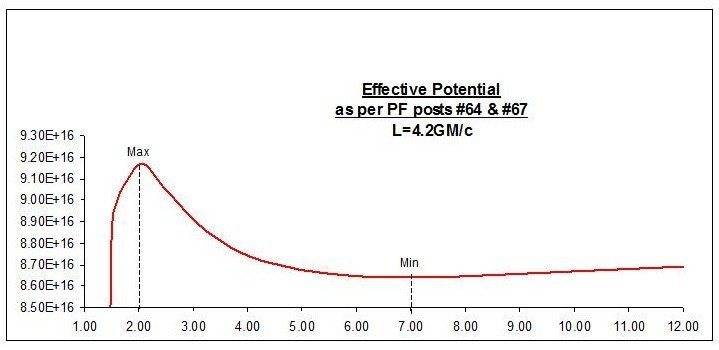

Part 1 of 2
There has been a lot of activity since I last looked at this thread last night (my time). I don’t have much time today, so apologises upfront if I have misinterpreted any statement of position, but wanted to try to comment on the exchanges that have taken place.
1. kev: pointed out that the value I was using (4.08E12) in my spreadsheet seem to produce a max/min curve if doubled. I also cross-referenced this with Jorrie statement that [L] should be greater that 3.4642GM/c. You're both right, I needed to use a minimum value of 6.08E12. However, this only seems to produce the quasi-stable maximum, which then tails off without a definitive minimum. However, I was rushing and may have made a mistake.
2. Also tried to quickly use Jorrie’s equation:
[tex]V_{eff} = c^2\sqrt{(1-2GM/r)(1+L^2/(r^2c^2))}[/tex]
Again, didn’t get the result expected, but I need to spend some time tidying up and checking my spreadsheet. So I will assume I have made a mistake.
However, I would also like to see if we could standardise towards some set of terms that then leads to a consistent and agreed derivation of effective potential, e.g.
Effective Potential (Veff)
Total Energy (Et); Kinetic Energy (Ek); Potential Energy (Ep)
Radial velocity ( [tex]v_r = dr/d\tau[/tex])
Orbital velocity ( [tex]v_o = \omega*r[/tex])
Angular velocity [tex][\omega] = d\phi/d\tau = v_o/r = mv_or/mr = L/mr[/tex])
Angular Momentum [L] = [tex]mv_or[/tex] Only valid for circular orbits
I believe that there is some value in stepping back and looking at the derivation of effective potential in a purely classical form. I have several sources, which appear unambiguous and lead directly to the classical minimum Veff curve associated with the appropriate value of angular momentum [L] required to balance the orbit at a given radius [r]:
Et = Ek – Ep
[tex]Et = 1/2mv^2 + (-GMm/r)[/tex]
[tex]Et = 1/2m\left( v_r^2 + v_o^2\right)-GMm/r[/tex]
Based on the assumptions above:
[tex]Et = 1/2m\left( \frac{L^2}{(mr)^2}\right)-\frac{GMm}{r} = \frac{L^2}{2mr^2}-\frac{GMm}{r}[/tex]
We might wish to normalise to unit mass, just to cross-reference standard text:
[tex]\frac{Et}{m} = \frac{(L/m)^2}{2r^2}-\frac{GM}{r}[/tex]
However, from a classical perspective:
[tex]Et = 1/2m\left(\frac{dr}{dt}^2\right)-Veff[/tex]
[tex]Veff = \frac{L^2}{2mr^2}-\frac{GMm}{r}[/tex]
[tex]\frac {Veff}{m} = \frac{(L/m)^2}{2r^2}-\frac{GM}{r}[/tex]
End of Part-1: See Part-2

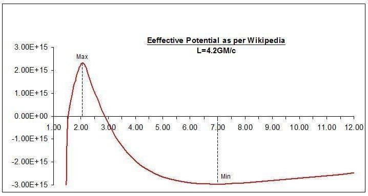

Part 2 of 2:
Sorry about splitting the reply, but the preview kept blowing up. Presumably the size was too big. Anyway, continuing...
From the outset, it was noted that the previous equations corresponds with the form in the Wikipedia reference, albeit with an additional relativistic term:
[tex]Vr = \frac{L^2}{2mr^2} -\frac{GMm}{r} - \frac{GML^2}{c^2mr^3}[/tex]
In an earlier posting I did a derivation from the Schwarzschild metric, which led to the following form. Note, the equation has been multiplied by m/2 to be consistent with the definition of kinetic energy [tex]Ek = 1/2mv^2[/tex]
[tex]1/2m\left( \frac{dr}{d\tau} \right)^{2} = 1/2mc^2\left(1-\frac{Rs}{r}\right)^2 \left(\frac{dt}{d\tau}\right)^2-1/2m\left(1-\frac{Rs}{r}\right) \left(\frac{L^2}{m^2r^2} + c^2 \right)[/tex]
I argued that because we were only considering circular orbits, [tex]dr/d\tau[/tex] could be set to zero. However, kev has raised the issue as to whether this is valid for the orbital radii under consideration. Any thoughts on this point? However, if we proceed with this assumption, we get:
[tex]\frac{mc^2}{2}\left(1-\frac{Rs}{r}\right)^2 \left(\frac{dt}{d\tau}\right)^2 = \left(1-\frac{Rs}{r}\right) \left(\frac{L^2}{2mr^2} + \frac{mc^2}{2} \right)[/tex]
As far as I can see, this is the root of the form:
[tex]\left(1-\frac{Rs}{r}\right) \left(1 + \frac{L^2}{r^2}\right)[/tex]
Which then gets translated into several different forms based on the substitution of the Schwarzschild radius [Rs] and the introduction of geometric units. However, the expansion of this term leads to the form:
[tex]\frac{L^2}{2mr^2}+\frac{mc^2}{2}-\frac{Rs}{r}*\frac{L^2}{2mr^2}-\frac{Rs}{r}*\frac{mc^2}{2}[/tex]
[tex]\frac{L^2}{2mr^2}+\frac{mc^2}{2}-\frac{GML^2}{c^2mr^3}-\frac{GMm}{r}[/tex]
The difference between the Wikipedia + classical derivation and the Fourmilab + relativistic derivations appears to be linked to which side of the equation you put the [tex]mc^2/2[/tex] term. On the basis of the classical definition, Veff is defined as the sum of the orbital kinetic energy plus the potential energy and therefore this term must belong on the left with total energy [Et], i.e. I think Wikipedia is right. Again, on the basis that [tex]dr/d\tau[/tex] can be set to zero, we have a direct correlation between total energy [Et] and Veff
[tex]Et = Ek + Ep[/tex]
[tex]Veff = Ek(v_o) + Ep = Et[/tex] if [tex]v_r = 0[/tex]
Of course, it is possible that the re-arrangement used in most relativistic text doesn’t actual change the basic tenets of the argument for the effective potential curves being suggested. However, it would be nice to use an equation, which is consistent and can show its derivation to be compatible with the classical form.
Really appreciate all the input. Any further thoughts?
