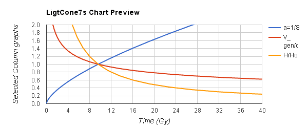

so to clear up my confusion- the universe was expanding at its fastest when the Big Bang occurred, right?
Additionally, even though the universe is accelerating in expansion, it's still decelerating? By this I mean that deceleration is still occurring, it's just happening at a slower velocity.

Here's a history of the H(t), expressed as a percentage distance growth rate"
Code:
year        fraction of percent expansion per million years
1 billion        1/15
11 billion      1/128
12 billion      1/135
13 billion      1/140
14 billion      1/145
15 billion      1/149
50 billion      1/173  (approx. equal to H∞ the longterm rate)
Our present-day growth rate in this year 13.8 billion is 1/144 % per million years
You can see it is tending to level out and in fact it is approaching a constant H. If you want I can attach a graphic plot.
Of course with a constant or near constant growth RATE, the growth of any particular distance between specified roughly stationary galaxies is EXPONENTIAL. So it will exhibit increasing speed of growth. Eg growing at 1/173 % per million years. I'm not concerned with that. I want you to understand the declining expansion rate. It has been declining ever since the big kick it got at the start, and it is gradually tailing off to H
That is what the Friedman equation says
H2 - H2 = [const] ρ
where rho is the combined ordinary and dark matter density. Matter density is declining so H is converging towards its longterm value H.
Present-day matter density expressed as energy equivalent per volume is 0.24 nanojoule per cubic meter. That's the same as 0.24 joule per cubic kilometer, which might be easier to imagine. A joule is enough energy to lift a 1 kilogram book up 10 cm. Or it's the thud when you drop the book back down on the desk.
The matter of all the stars, dust, gas, dark matter clouds, radiation, everything--in energy density units, averages out to this 0.24 joule per cubic km, or 0.24 nano joule per m3
If matter density is expressed in nanojoule per cubic meter, and H is in percent growth per million years, then the numerical value of the constant in the equation is 6.2×10-5 sometimes written as 6.2e-5
Here as a numerical check is the Friedman equation applied to presentday expansion rate (1/144 percent per million years) and presentday matter density.
1/1442 - 1/1732 = 6.2e-5 × 0.24
You can check the Friedman equation yourself, just put this into google window
1/144^2 - 1/173^2 and press return. Google has a calculator and will tell you what the lefthand side is
And then put in 6.2e-5*0.24. Google calculator likes the asterisk for multiplication. It will tell you the righthand side. The two agree. That's the Friedman equation. (in the simple case where space, not spacetime however!, is flat, as it seems in fact to be)
You can play around with different times and different growth rates. You can use the equation to find out the density of ordinary and dark matter in year 1 billion, when H was 1/15%
Google calculator is very handy for this: Just paste in
1/15^2 - 1/173^2 to get the leftside and then divide by 6.2e-5 to get the rho on the rightside.
It will be a much larger matter density than the 0.24 we have now. Because a lot earlier.The point about the rate tailing off to a constant is that to the extent that we have a constant expansion rate we have exponential distance growth at a constant percentage growth rate. So if you look at a specific distance between two essentially stationary galaxies, that distance is growing exponentially. The speed of distance growth, for that particular distance you are tracking, is of course increasing and naturally it is not limited by c because this is geometry change, not ordinary motion. Nobody gets anywhere by it, everybody just becomes farther apart. Not good to think of it as ordinary relative motion (which is limited by c.)

Sorry, yes, you're right. It does grow, as its radius proportional to 1/H_0, while H_0 is shrinking. As H_0 is asymptotically approaching a constant value, however, this growth of the Hubble radius should be decelerating.
Chalnoth said:
...however, this growth of the Hubble radius should be decelerating.
Indeed! The Hubble radius is approaching a limit of 17.3 billion light years.
At present it is 14.4 billion LY, so it has a way to go still. The growth speed of that distance quantity is slowly declining.
In this table the age of expansion increases about 100 million years each step
{\scriptsize\begin{array}{|c|c|c|c|c|c|}\hline R_{0} (Gly) & R_{\infty} (Gly) & S_{eq} & H_{0} & \Omega_\Lambda & \Omega_m\\ \hline 14.4&17.3&3400&67.9&0.693&0.307\\ \hline \end{array}} {\scriptsize\begin{array}{|r|r|r|r|r|r|r|r|r|r|r|r|r|r|r|r|} \hline S&T (Gy)&R (Gly) \\ \hline 1.000&13.787206&14.399932\\ \hline 0.993&13.887300&14.445708\\ \hline 0.986&13.987566&14.491047\\ \hline 0.979&14.088288&14.535790\\ \hline 0.973&14.189319&14.580014\\ \hline 0.966&14.290655&14.623720\\ \hline 0.959&14.392293&14.666909\\ \hline 0.953&14.494229&14.709581\\ \hline 0.946&14.596459&14.751736\\ \hline \end{array}}
And at first the Hubble radius increases by 0.19 Gly, or about 190 million LY, so speed about 1.9c
But by the end of the table the increase is only about 184 million LY, in about the same amount of time.
The speed of radius growth has declined. This is not a speed of MOTION, or of the expansion of a cosmological distance, but it is the speed of growth of a well-defined distance Δr/Δt

The whole content of the discovery was the the decline of H is not going to zero but is leveling out at a positive H.
This possibility was allowed for in Einstein original GR equation, the Lambda term appeared around 1917, there was no "dark energy". DE is a hyped-up myth that appeals to laymen, journalists, and some types of scientist. They keep looking for evidence that the positive longterm limit H (basically the cosmo const Lambda in disguise) arises from some sort of "dark energy". But they have failed for 17 years so far to find evidence. The behavior is still most simply explained by a positive Lambda constant in the equation. So its up to you, you can take part in the DE fantasizing or you can reserve judgement and go with the simpler explanation (until and if they find solid observational evidence for DE). It's kind of a matter of personal taste.
Longterm H equal to 1/173% per million years (see table post #7) is equivalent to saying
Hubble radius is increasing to a limit of 17.3 billion light years. Two ways of saying same thing.

The current rate of distance expansion is about 1/144% per million years.
Any largescale cosmic distance like between two distant galaxies or clusters of galaxies is increasing by about 1/144 of one percent of its size in a million years.
This expansion rate started out really big and has been steadily declining over time ever since.
That is something we can SEE by looking back into the past and it is also something the GR equation and its simplified causing the Friedman equation tell us MUST BE. It is related by the density of ordinary and dark matter. (We can see and map DM, by its optical effects. It is not a myth like DE may well be.)
It now turns out that the curve of decline, when you plot it, doesn't look like it is going all the way to zero but looks like it is leveling out at a positive percent distance expansion rate of 1/173% per million years.
That target rate is tantamount to the cosmological constant that Einstein discovered in 1917 could be (in fact had to be) added to his equation. There is room in the GR equation (our best model of how gravity works, tested meticulously for almost 100 years) for just two gravity constants: Newton's G, and Einstein's Lambda.
When you have a constant or near constant percentage growth rate then the SPEED that individual distances grow (once you specify what distance you are talking about so there is a definite speed to talk about) follow an "exponential growth curve" like money growing at 3% interest. So that is the increasing speed people talk about. It doesn't require any "push" or "energy". It is just what the equations (which tell how geometry evolves and how that evolution is affected by matter) say that geometry must behave.
I'd get familiar with this table, so when you talk to your friend and say what is increasing and what is decreasing, it means some thing definite.This from post #7, back a ways. It has some surrounding explanation.

From 11 billion to 12 billion the denominator increased by 7 (from 128 to 135) that is one way that shows a fraction getting smaller, increasing the denominator.
From year 12 billion to 13 billion the denominator increased by 5---not as much.
From 13 to 14 billion, again by 5.
But from 14 billion to 15 billion it only increased by 4!
I wouldn't use the words acceleration and deceleration to describe this at all. H(t) is all important, it runs the show and it is what the Friedman equation is ABOUT, but it is not a speed.
The important thing about H(t) is that as time goes on it is stabilizing as a constant percentage growth rate
AND GROWTH AT A CONSTANT PERCENTAGE RATE IS EXPONENTIAL.
Understand exponential growth. And if you pick some sample distance to watch grow, the growth can be expressed as a speed. And that speed can increase. In fact in exponential growth with constant (or near constant slowly declining percentage rate) the speed DOES increase.
That's all the hype and screaming about "acceleration" and "dark energy" is about---it is a way of telling you that distance growth curves are evolving towards exponential growth shape, with a longterm constant percentage.
It's a way of telling you that which appeals to the journalists and the lay public, who like to hear about "energy" and are thrilled by putting the pedal to the metal and "accelerating".
Before year 7 billion or so, the H percentage growth rate was dropping so fast that you didn't get exponential growth. Like the bank paying you 3% on savings the first year and then 1% the next, and then 1/4% the next.
Contrast that with a steady or nearly steady rate.
The first year you have 1.03
The next year you have (1.03)(1.03) times your original money.
The next year you have (1.03)(1.03)(1.03)...
Each year your dollar gain is more.
That translates into increasing speed when we talk about distances instead of dollars.
As long as the interest rate is steady, or declining but not too fast, you have a basic exponential growth shape.
So it is the APPROACH TO CONSTANCY of H(t) percent RATE that translates into "acceleration" of whatever distance you choose to track's growth speed.

You can read off the size of the radius of the Hubble sphere, in billions of lightyears, from the denominators of the percentages in the earlier table
Here's a history of the Hubble radius R(t)
Code:
year        Hubble radius in billions of lightyears
1 billion        1.5
11 billion      12.8
12 billion      13.5
13 billion      14.0
14 billion      14.5
15 billion      14.9
50 billion      17.3  (approx. equal to R∞ the longterm size of radius)
Our present-day Hubble radius in this year 13.8 billion is 14.4 billion LY
You have to remember to put in the decimal point.

No, without any form of dark energy, the expansion and recession curves would have looked like this:
Compare this to the presently accepted curves given in the other thread: https://www.physicsforums.com/threads/dark-energy-question.847947/#post-5317959
