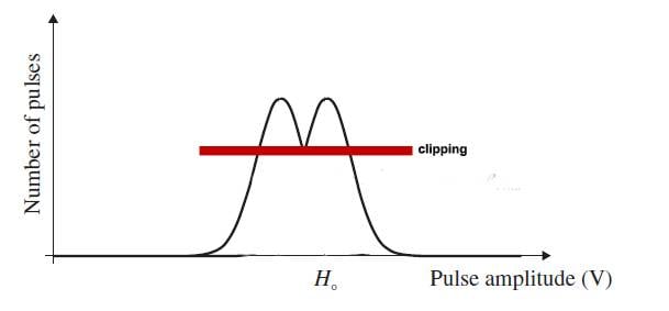

Hi. I'll throw my two-pennyworth in. Maybe your professor meant this...
If the amplifier gain is *too* high, saturation may occur. By this I mean the output from a large pulse entering the amplifier would exceed the maximum amplifier output (saturation).
This image shows the effect for an over-amplified sine wave: https://qph.fs.quoracdn.net/main-qimg-1b10e586fd0b3b0025d27fa421e313a5
The output has the top of the pulse 'clipped', leaving the broad lower part of the pulse and a flat top. The overall effect is that the efflective pulse-width is increased.
You can imagine a situation in which 2 close large pulses would then appear as a single pulse because their lower parts overlap - and the amplifier output remains saturated from the start of the first pulse to the end of the second pulse. (A bit like resolution of diffracted point sources in optics.)

you mean something like this :
now i got what he meant !
thank you so much
