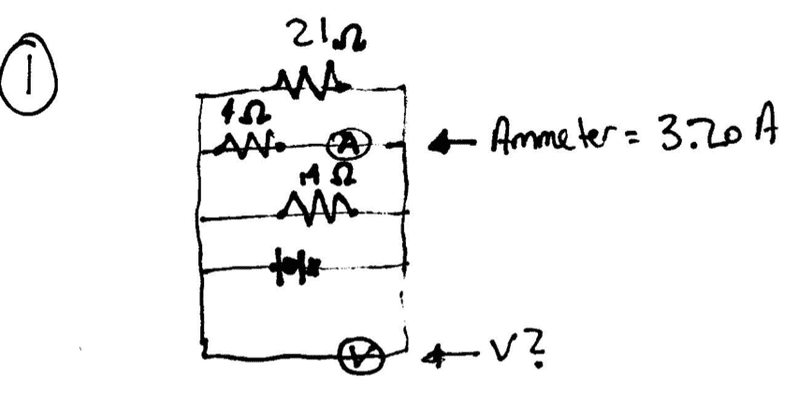

1: If you have a circuit (See file 1) where the ammeter reads 3.20 then what will the voltmeter read?

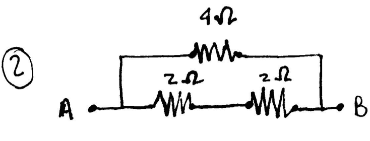

2: If you have a circuit (See file 2) where the resistance points are 4, 2, and 2, ohms then what will the equivalent resistance be between points A and B.

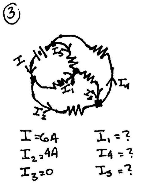

3: If you have a bridge circuit (See file 3) where I=6A, I2=4A, and I3=0 then find I1, I4, and I5.

Eg, in the second question I don't even know if the circuit is considered a parallel or series circuit! Which one do you think it is?
Split the problem into smaller parts then.
Do you see some resistors which are in parallel? That means that you have two resistors where the corresponding sides are connected.
Do you see some resistors which are in series? That means that you have two resistors in a line without a branch in between.
Ohms Law is a good place to start, specially for circuit 1 and 2
V = I x R
1) a hint All the resistors are in parallel across the battery, so the voltage across each resistor is going to be the same
2) work out the total resistance on the bottom line, the 2 x series resistors then you now will have 2 resistors in parallel
Then use the parallel resistor calculation to work out the total resistance ... google search "parallel resistors"

By the way, how should I start on question 3?
With Kirchhoff's laws.
Do you know the resistances of the resistors (or at least the relative resistances)?
Start by dwelling on the implications of being told that I3=0
