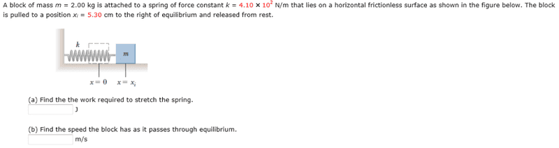

#1.
For this one, I did
a) W = ½kx² = ½*410*.053² = 0.5758 J
b) V = √[2W/m] = √[2*.5758/2.00] = 0.7588 m/s
Are those right?

riseofphoenix said:
#1.
For this one, I did
Are those right?
If so, can you help me solve Number 3 and 7 real quick!
Those answers look good.
I suggest posting #3 & #7 each in its own thread.
You will also be expected to post an attempt at a solution for each.
