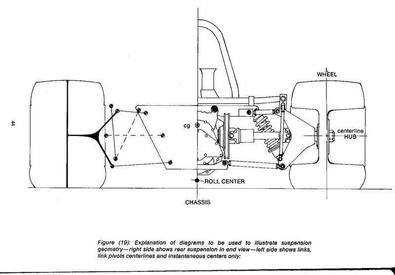

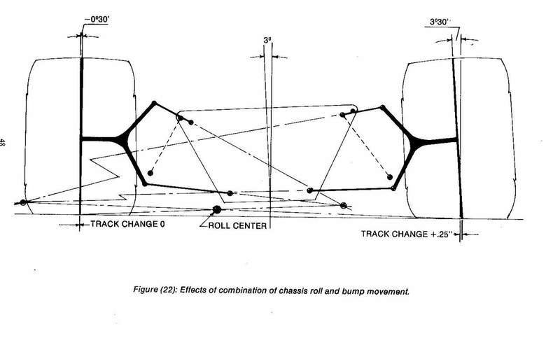

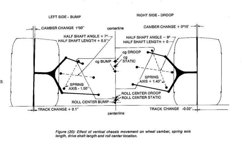

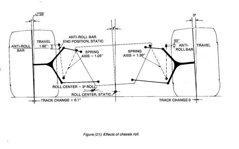

Overall height of the spindle upright effects Roll Center (RC). shorter spindle height ( upper Ball Joint to Spindle shaft center line) with everything else the same, will LOWER the RC height. This is because the shorter spindle produces a longer instant center. the shorter instant center to the wheel it is drawn from , the higher the Roll Center.
you can change the RC by shortening the lower BJ center distance relative to the Spindle shaft center line as well.
you can lower the RC by raising ( relative to the track surface) the inboard upper A-arm mounting point.
you can lower the RC by lowering ( relative to the track surface) the inboard lower A-arm mounting point.
get performance trends software to take the headache out of the calculations..

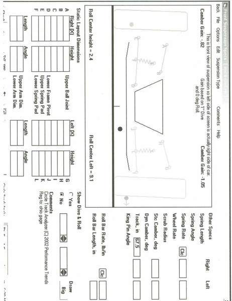

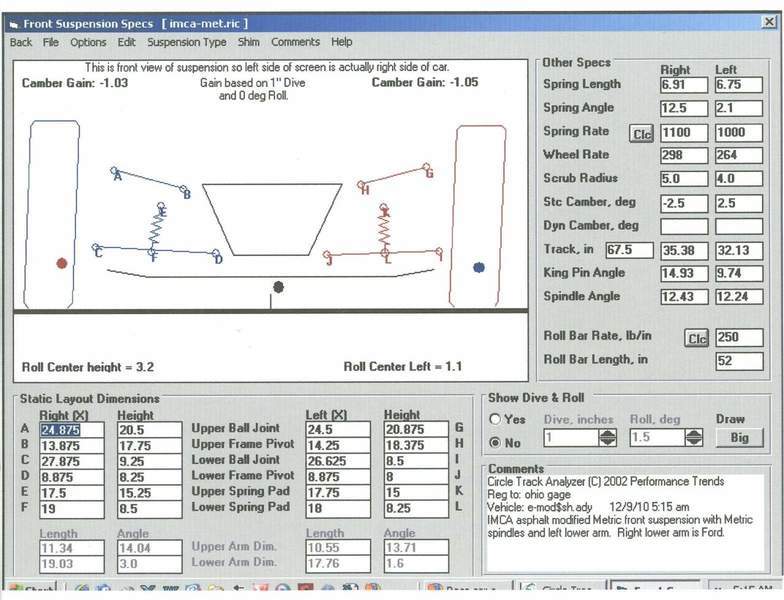

Back again...Mike, I am curious about the front roll center location left to right in a pavement sprint car. I've noticed that Beast and a few others have the stand off on the right front for the panhard mount quite close to the frame, where as my car has the stand off quite close to the coil over. Let's say for arqument sakes that my front panhard bar is 6" longer then on a Beast chassis. Assuming that the roll center falls in the middle of the front panhard , then my front roll center would be 3" farther to the right then the Beast chassis ( also assuming that they both mount to the axle in the same location relative to the LF ) ? Now Bob East is no dummy and I am assuming he's done this for a reason. My friends tour car has a front roll center 3" under the left front tire ( Kelly Tanner's old chassis ) I have to assume this was done on purpose as well.
As allways I look forward to your response...Kenny

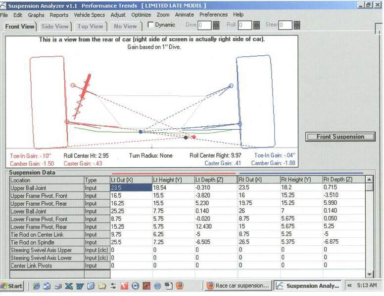

I had to read your prior posts ..you have 10 high Roll Center..and run pavement, not dirt track
i know the Emod guys run RC offset 4 inch bias to right for jacking effect..but these Emod guys use the General Motors Metric frame..A-arms coil springs off big GM cars as cost saving measure..( cost savings and Racing is like saying you get lots of sex after being married for 5 years...yeah right...)
straight axle rockets like you have use leaf springs / panhard bar set up on the front which are least expensive, lightest , simplest form of positive locating method.
the axle does not move purely vertical, it arcs around the chassis pivot with radius equal to the length of the P rod, so either the axle or the chassis has to shift sideways a bit whenever the axle moves vertically up or down over bumps...you got perfectly smooth track , right??
one draw back is the spring tries to fight the panhard bar during movement so to keep the lateral movement to a minimum the longest Panhard bar as possible is used.
finally the roll center is located where the center line of the P bar intersects with the center line of the car so it moves some what when either axle travels vertically or the car rolls.
i would stick with offset to the right..dirt guys run offset to the left..which is their hot setup..exactly where is your front RC offset from vehicle center line?
Mike...my front panhard bar length is 31" OAL. From the center of the axle to the panhard mount on the left side of the axle is 11.5"
Mike...one more thing. Should I make a " bolt-on " front panhard bar bracket for the axle so I can tip it up and down to keep the bar level as I move it up or down on the frame ??
Thanks...kenny

Kenny, please confirm the distance the pbar crosses the vehicle center line as this is the roll center.
These #'s are correct Mike. I can't move the mount on the axle any farther to the left, because the coil over is right there. There is about 1/2" clearance between the frame and the coil over and its only 7" to the king pin CL from there ( just enough room for the steering arm to clear the coil over and 4 link brackets.) This car has exceptional LS for a sprint car at 58.2% LS without driver. From the center of the rear end its 31" to the outside of the LR and 43" to the outside of the RR ( the max offset allowed by our rules ) the front end is 1/2" narrower on each side.
kenny
sounds like we can not change the RC via panhard bar...let me talk to some old hands at the track tommorow..
Mike...would it matter if the panhard bar was mounted off the back side of the axle ? I could get it closer to the LF then...between the 4 link brackets ??
Thanks...Kenny

Kenny let me check with my software guy to see if he has program to calculate roll center on your car..we are at the point where we got to look at other things to drop the RC..all you do is tape measure mounting points and plug them into the program to see how it effects RC location..
