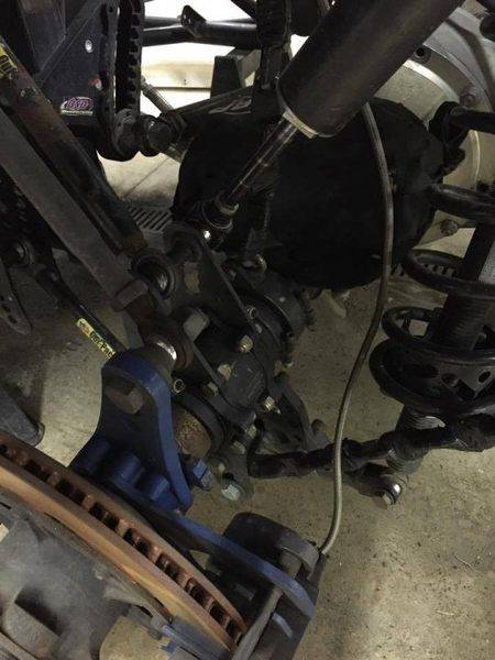

Here is a question that will make you think. I understand that dampers (shocks) are there to control vertical acceleration. I race dirt modifieds an have recently stumbled across a rather unusual setup. In the attached picture this person did not attach the shock to the standard pre-axle orientation. They mounted the shock on top of the birdcage by the upper link. By my calculations and physics knowledge it looks like they are trying to use the shock to help keep the car "on the bars." Judging by the angle it looks as though the shock is mounted 60 degrees from the horizontal. From a linkages perspective the optimum amount of work achieved is at 90 degrees which is what the shock relative to the upper link looks to be.
From a force perspective this creates two vectors in the x and y direction (looking at the left side of the car x= front to back y=vertical). With the force being broken up into two components with a 60 degree angle you get 86% (sin(60)) damping in the vertical direction and 50% (cosine(60)) damping in the horizontal direction. The damping in the horizontal direction seems like it would aid in getting the car up on the bar and keeping the car on the bar. In a "normal" setup the shock is only damping vertical motion thus there is no dynamic control over the rear steer that is being applied when picking up the throttle. With the big pop up shocks (9-1) that are on these cars currently running do you think this could be beneficial? Am I looking at the problem correctly? What is your input?
http://www.4m.net/attachment.php?attachmentid=56643&d=1478544265
  • Close-up photo of a race car's rear suspension showing a shock absorber mounted on the upper chassis near the birdcage, with brake rotor and caliper visible at lower left.
Wylde you are thinking 2-D when you should be thinking 4-D
On dirt cars the bird cage is a “bearing” mounted on the rear end housing with two mounting tabs. The suspension linkage is connected to these. This linkage is meant to use body roll to rear roll steer the car. It does this under or over steer by using the body roll to shorten the wheel base on one side and lengthen the wheel base on the other side. As the car body settles in the turn and the drive starts to accelerate , the rear end returns to the equal wheel base position and ends the rear roll steer event. For a short period of time the rear end is pointed toward the inside or outside of the track and the car will drive that direction until the tires hooking up correct the wheel bases and rear steer goes away.
Now if all cars are running this set up in a race and some genius figures out how to keep the car in roll over/under steer LONGER than the other cars, then this car will be able to drive deeper and longer and have an advantage. Roll over steer on dirt means the car will hold traction and not go into rear tire shear as it would with wheel bases equal ( no rear steer present). We keep the forward traction as the oversteer turns the car.
The shock (damper) used on the bird cage is used to TIME the rear steer event. It can be set up to hold the rear steer for a longer period of time or attain the rear steer at a more adventageous point in the corner. Think " tie down shock". It keeps the rear over steer locked in until the traction overcomes the"tie down shock". Compare this to the other car relying on the body roll and settling to return the chassis to a no rear steer setting. He is through the turn and back to a no rear steer position before you are. Your car has gone through the same body rolls and sets the damper to a " tie down " position and holds the rear over steer so you drive by the other car that is losing traction since its wheel base is now equal.
Remember.. Rear steer does nothing for you going into a corner when you are off the gas. It will help when you get on the throttle. I have seen a lot of these birdcage/damper setups. Some even use a pull bar and damper.
So think 4-D with TIME being the other critical factor.

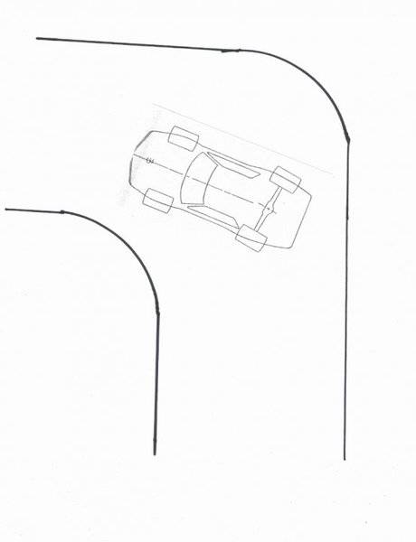

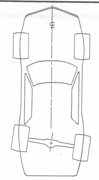

Rear Roll Over Steer – say that three times and try to kill a Budweiser. Before we figure this one out we need to understand the spin out and why it happens. Or in a more scientific manner, why does the race car lose traction in a turn? During cornering the momentum overcomes the ability of the tires to maintain proper contact with the track. Let us look at the tire contact patch of a 10 inch race slick it looks to be about 50 square inches of sweet contact footprint in a nice square pattern. It is all adhesive area and no slip area. Now enters the dreaded Slip Angle. All slip angle is can be summed up in the difference between where the tire is pointed and where the tire actually goes in a turn. The greater the slip angle the more the pattern changes from all adhesive contact area to less adhesive and more slip. Its shape and center also changes. So as the slip angle increases our chance to spin out also goes up.There is a formula to figure out your tire foot print or contact patch but if you know there is an 800 pound gorilla in the room you don’t need to know his shoe size... you just need to know how to get rid of um!

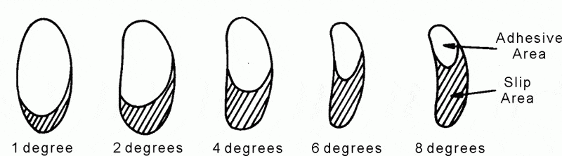

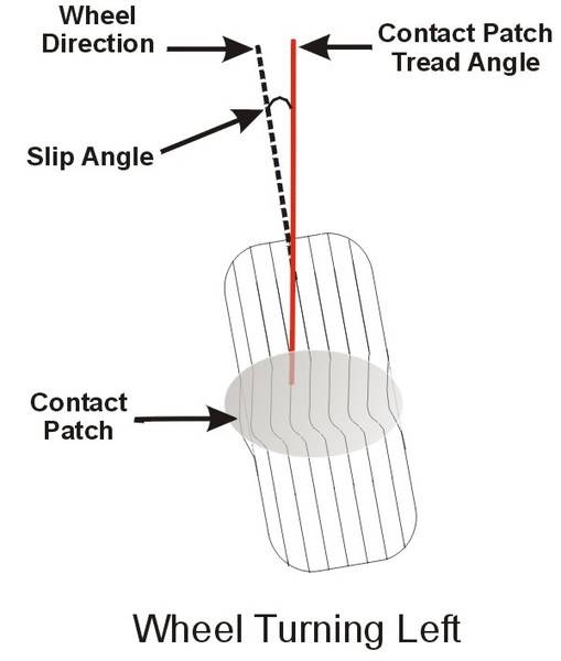

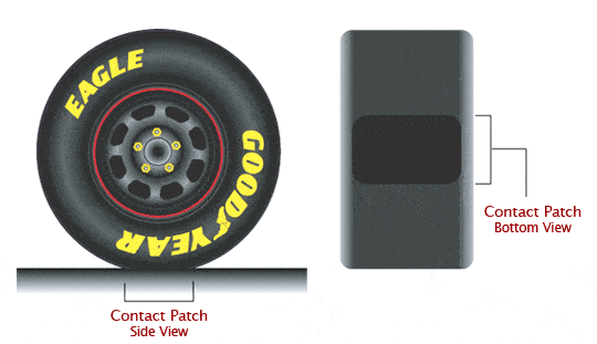

  • Diagram of a race tire with yellow Goodyear Eagle lettering, showing its contact patch from a side view on the road and a bottom view of the patch as a dark rectangle.
  • Diagram of a left-turning wheel showing wheel direction, slip angle, contact patch tread angle, and the elliptical contact patch on the tread.
  • Five tire contact patch diagrams labelled 1 degree, 2 degrees, 4 degrees, 6 degrees and 8 degrees, showing adhesive area as white and slip area as hatched, with the slip area growing as the angle increases; the 8 degree diagram is labelled Adhesive Area and Slip Area.
  • Geometry diagram of a circular arc over a flat base: arc length s, chord c, height H, angle α and radius R, with formulas s = 2Rα, c = 2R sin(α) and H = R cos(α).
Now that we know about slip angle and tire contact patch, how can we use it to our advantage?special thanks to steve smith and Paved Track Stock Car Technology #S239 from steve smith autosports
  • Line drawing from above of a car chassis showing the centre line marked CL, four wheels, and a rear axle with a centre marker and a dashed centreline.

  • Hand-drawn top-down diagram of a race car on a curving road, with the car angled across the lane as it turns, with a line showing its path.

The correlation I am drawing from your post (namely SA2.jpg) is that slip angle has an inverse relationship with traction. The more slip angle the less traction and vice versa. Its amazing such a simple diagram can explain so much. This brings up an important question, how do you tune the car to maximize slip angle?

Your question - how do you tune the car to maximize slip angle? I would say we tune the car to maintain maximum tire contact patch on all four wheels in the turn. We do this by proper camber build on the front. Most times we race a solid rear end housing and once we build in the camber, that’s about all we can do besides getting stagger right.
Your question - how can you utilize roll over steer to create heat in the tired without getting them so hot they glaze over.
Roll over steer is used on 4 link suspension on DIRT tracks. Not recommended for paved track.
It is used to maintain traction on dirt by virtue that the rear end is pointed outward and continuing to drive the car. Compare this to equal wheel base set ups that restrict the rear end “ pointing” and force the tires to transition for traction to shear because the wheel bases are equal during the cornering. See post # 1126 the bottom green cars tire contact patches are perpendicular to the line of travel. The green car above this one is sliding in the turn and has tire contact patch's about 45 degree off set from the line of travel

your question - Do you think it is possible to add in a coefficient for the amount of roll over steer that is induced when the car is hiked?
How much rear roll steer you get depends on your linkage settings. Today the hot set up is to lock in the rear over steer once it happens with tie down dampers.your question - Is there a correlation between stagger and roll over steer or are they two separate variables? Are they additive or multiplicative?Stagger and rear over steer are both efforts to maintain the maximum tire contact on the track. Running a locked differential means you u have to compensate with roll differences in tire diameters so you don't shred the tires when turning. Roll over steer is an effort to maintain as much traction at power on as possible.
are they additive? I don’t know but they both better be right or you aren't going to turn the car with maximum performance.

Sorry Mike. I race a vintage modified with a Ford inline six cylinder. It has a straight front axle with a 4 inch drop. I use a single transverse leaf spring that is mounted on top of the axle. I use a panhard bar to locate it.
  • Photo of a partially built race car chassis frame in a workshop, showing a rear suspension assembly with a black tubular roll hoop, a metal frame and a red tool or part on the bar.
We figure the roll center by finding the linkages that prevent the side to side movement of the chassis during cornering. Typically on a single leaf spring ( with multi leafs) front beam axle set up, like the old Ford T-bucket hot rods run, we have a multi leaf spring. This spring has spring eyes at each end. A shackle linkage connects the spring eye to the axle. Where the shackle bolts to the axle is the data point we need. Measure the distance between each point and the midpoint is the Roll Center.
The panhard bar you have negates the above as the Roll Center. The Roll Center height and offset when using the panhard bar is the mid point of panhard bar. This roll center may very well be many inch off set from the cars center line. It depends on the panhard bar length.
All the adjustment used on a rear mount panhard bar apply to the front mount panhard bar.
I grew up watching 32 Duce coupes racing flat head V8s and Ford inline 6 cylinder 300 cid monsters. The 6 cyl. block had 7 main caps and was bulletproof. That was racing. This set up can take a huge amount of abuse and once you learn to drive it, you can have a ball racing it.
Thank you. I use the 240 inline that is the little brother to the 300. I have been racing this car for 2 years and this year I want to optimize my suspension. Would the Performance Trends software help me to determine the best front roll center location as related to the rear? From what I understand so far in reading this forum and from other sources the front and rear roll centers need to be designed so that the two ends of the chassis aren't fighting each other when cornering. With these cars we have to make most of the brackets ect.. so it wouldn't be difficult to make changes.
