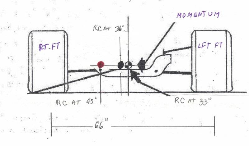

  • #1,051
Here is what the left A arm looks like.
  • #1,052
I assume this is what you meant by "reducing the roll center offset".
  • #1,053
height is great, offset needs to be about 3 inch to the right to put down force on right front tire so car can turn in without skidding tire. You are close to getting it spot on! where is the RC in 2 inch of roll?
  • #1,054
The roll center is at 3" to the right now. With 2" of roll it goes to 7" to the right. I tried using the "Optimize" button there but it always messes up the roll center. When I change the angle of the a arms trying to get the camber gain correct it messes up the roll center.
  • #1,055
This is the most important thing you can do to get to a winning car. You may have to spend HOURS on the software. Try longer A-arm length, try milling the bottom of the spindles, different ball joint heights ( taller and shorter) maybe shim the bottom A-arms to move them out...it took me a week at nights messing with t he software to get RC with minimum movement and good camber build. it was worth it. keep copious notes so you don't start repeating your mistakes.

  • #1,061
fr roll center three inches to the right is good start..

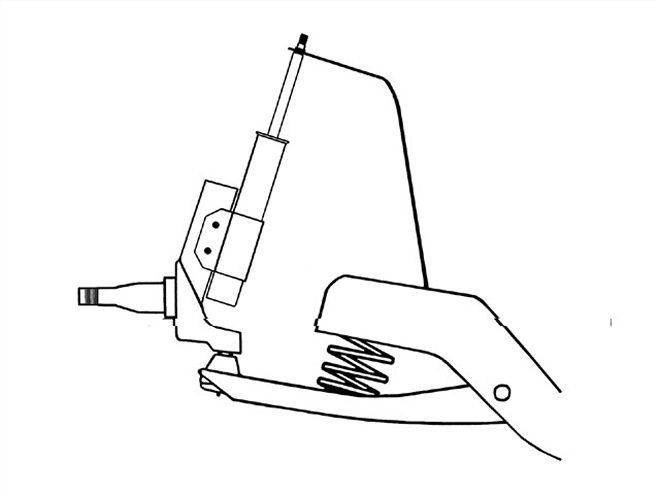

Tips for racing a Macpherson Strut car
1. Make sure you have a Limited Slip Differential drive (LSD). You will need all the help you can get putting power down during mid turn to Exit. Get both wheels working for you and reduce inside front wheel spin.
2. Biased much more heavily towards entry over steer. You want as much front weight bias as you can get away with. This will hurt braking, but you aren't going to be braking all that much and you need every ounce of weight on those front wheels. Realize that Turn entry is the only chance you get to rotate the car. Rear diagonal load transfer is going to the right front drive tire. Bias the static weight on the inside front, and get more grip out of that inside front tire. Your rear tires are just along for the ride. Get as much left to right load transfer as possible WITHOUT lifting the left from tire. You do not want to open the LSD and lose traction.
3. Set the rear bar and/or spring until the inside rear lifts off the ground at entry.
4.. Tune the front spring to where power-down started to suffer. Get as much left to right load transfer as possible WITHOUT lifting the left from tire. You do not want to open the LSD and lose traction.
4.. Reduce the positive camber gain and to set enough static negative camber to give you maximum tire contact path on the right front tire.
5. Learn how to properly BRAKE to set the car. Practice to get the over steer you want with hard, short, quick braking. We want corner-entry over steer, and given that we want a lot of rear lateral weight transfer (to help plant the inside front). We are going to lift the inside rear off the ground on corner entry. We may have to add more front spring / ARB rate.

look at post # 589 on page 301. The total amount of momentum to be countered by the the tire contact patch and spring / ARB package during cornering
Tw= Gs x car weight x CGh / track width
we assume the camshaft center line is the CG at 15” and the spec tires are crap and hard as wood pecker lips so we only get 1.0 G grip. Track width 66”
1.00Gs x 2650 x 15 / 66 = 602 total load transferred during cornering.
602 load transfer has to be countered by two springs and one ARB so we divide it by 3
602 / 3 = 200
typically you would l run a 220# ARB (sway bar)
ball park rears are 200# LR and RR with 3 point link
but typically you will end up with
175# LR and 150# RR
