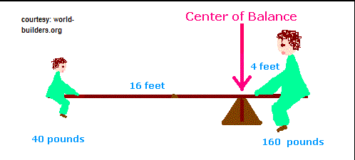

Spring rate is when you compress spring one inch and read the total pounds it takes. 200 # per inch.
Wheel rate is spring rate adjusted by the mechanical advantage of the lever, in this case, the bottom A-arm length. It is the motion rate of the linkage squared.
More specifically stated – Motion rate is the inner pivot point of A-Arm to the spring mounting point divided by the distance from the inner pivot point to the lower ball joint on the A-arm.
Next we calculate Wheel rate but we have to figure spring mount angle, cosines and square up motion rates and see post 17 on page 2. Then we go into Wheel Load rate and square instant centers. Lovely! As with any lever, the longer the leaver, the more mechanical advantage we have. Think tetter totter and the fat kid next door sitting in the seat and you being the fat beer drinking 200 # slob scooted closer to the fulcrum or middle point of the tetter totter. Thus a small kid equals the fat slob thru mechanical advantage. You have a much shorter lever than the fat kid.
Longer levers and A-arms mean less effort required to compress a spring over a set distance. Same with a damper or shock absorber. So given the same spring and shock absorber, but with two lengths A-arms, the longer one will be “softer”.

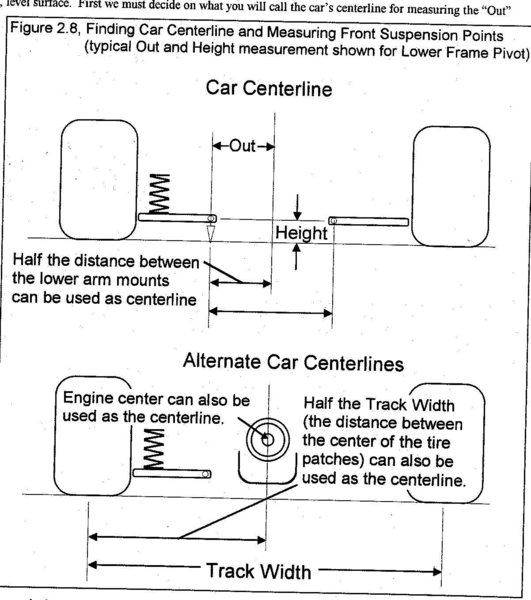

With the off-season upon us and time to make our cars better, I have a question. I have and will again measure my front to plot out the roll center in hopes of improving our performance. But before I embark on that task I have a question concerning determining the correct center line.
When laying out for the roll center should I use half distance between the frame rails or the midpoint between the tread width. When reading through the posts here I have seen both mentioned but not in a clear manner to understand the correct method. The reason I ask is we have a asphalt modified and not only is the chassis is offset several inches the wheels differ in offset by 2+ inches.
We also have different length lower control arms to compensate for the chassis and wheel offset. I am trying to get the most accurate determination of the roll center and make the car better for 2019.
Thanks in advance
  • #1,376
I always used the center line determined from the lower inside A-arm mounts and painted a center line on the bottom of the frame and top at several locations. This was done with the wheels and A-arms off the car when I was going thru the rebuild process annually. I liked to see just how much offset the car really had. Real easy to do if the air cleaner center bolt is sticking up like a flag on Iwo Jima up and the center line is 4 inch to the right of it!
I always put a piece of roll bar foam over the top side marking. Just paranoid crew chief thinking I guess.
Another advantage is the center line travels with you and can be used to rebuild the car at the track if you wad it up. Down side was that a sharp competitor could see this too if he got close enough while the car was in the pits. The Track width method is ok as well but remember to set aside a complete set of tires and wheels marked SET UP so you will have the same set up each time.

Thanks Ranger Mike, To me it was the most logical place but in seeing other references I was wondering if I was ding it wrong. As always great info here to keep referring back to.
