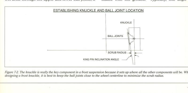

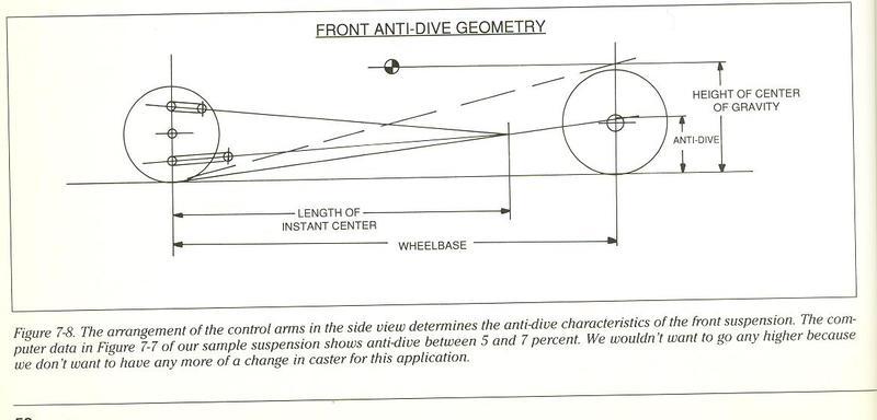

Here is my project. I am starting to design a new style front suspension for a dwarf car. For those of you that may not know much about Dwarf Cars they are a scale race car that weighs 1240 lbs, use a 4 cylinder motorcycle engine, and a cut down Toyota rear end. The front end that most of them use is a old style single kingpin set up with long rear struts that go back to the front upright of the roll cage. What I'm wanting to go to is a more modern upper A-Arm/Lower Control Arm set up using heim joints instead of ball joints. My idea is to start with the front end of a Dirt Late model, scale it down, and work form there.
Any and all opinions and thoughts are welcome and as I get more into the project I will post update and pictures.
Thanks
  • #187
Welcome. It sounds like you thought things out pretty good. When you are finished wit the measurements, send them to me and i will run them thru the software to find the roll centers. What type of rear suspension is on the car? There is a whole lot of work required to glue on a new front end...hopefully you have the time money and tools..thank you for inviting us on this venture andlet me know if i can help..

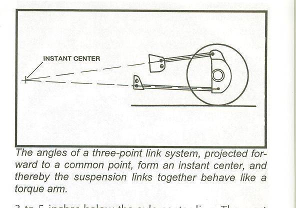

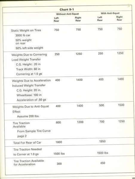

before you start changing angles, the basic problem is the LR is cold..right..you need to add more cross weight..this will help cool off the right front tire as well..rule of thumb..if the LR is 25 degrees cooler than the right front, you do not have enuff cross weight,,,add more at the LR..do you have scales?
  • #203
Yes the car has been weighed but we don't see much improvement when we change corner weights.
With the car running parallel bars we probably are not experiencing much anti squat and the car always appears to fall over on the right rear.We have raised the rear roll centre to help with this.
The reason I am concerned is we buildng a new car and not to sure which way to go.
The rules are fairly open regarding suspension.
We are looking at a 3 link with pull bar for 3 rd link as well as a 4 link but have no experience with either of these set ups .
Any ideas would be appreciated.
  • #204
3 link is easier to learn but the hot set up on dirt is 4 link and i would start there. the question is, will you keep the present set up? if so we need to know a lot more information..if not, then any data regarding set up will not be useable.
