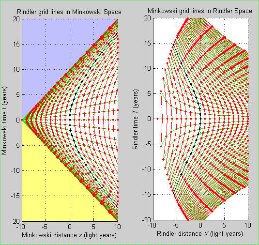

In an old (2008) thread, DrGreg posted this transformation from a Minkowski chart to a Rindler chart
He also wrote:
I haven't drawn the photon worldlines either, but you can imagine them joining the red dots across the diagonals of each distorted "square" of the grid.
My question: using these photon worldlines, does a two-way radar measurement give a valid radar distance between two points in the Rindler frame, as per this zoomed view?
The two vertical dashed lines are Rindler observers and the blue arrows are radar signals send and received by each of them. They attempt to measure the radar distance between the same two inertial particles at different times. If correct, it appears as if the radar distance between the two particles are increasing over time.

You are correct (assuming diagram is to scale). Is there any particular reason you find this surprising?
However, when I do the math, unless I've blundered, I come to the opposite conclusion. The radar distance between two constant Minkowski position world lines, as measured by a given Rindler observer, decreases with time (from t=0, t as conventionally defined for Rindler). Of course, by symmetry, for t increasing toward t=0, the distance increases with time.

No, Rindler and radar distance are not the same. For any Rindler observer, radar simultaneity matches Rindler coordinate simultaneity, but Radar distance does not match 'ruler distance' along a line of simultaneity. However, I took that into account in my calculation (but I only considered a small spacetime region, and used a series correction to ruler distance to get radar distance). If more terms of the series correction become significant, the result might change. This doesn't make one distance any more or less valid than another, as coordinate distances. However, the Rindler coordinate distance is the proper distance measured along simultaneity surface.
[Edit: done exactly, rather than approximately, I get the same result. Radar distance measured by a Rindler observer between two constant Minkowski position world lines decreases with time for t increasing from zero.]

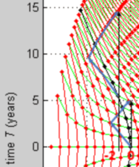

This then still leaves the question: what distance is represented by the increasing two-way "radar distance" on DrGreg's Rindler diagram (as in my 'zoom' graphic), calculated as 2-way elapsed Rindler time divided by c?

I think trying to be precise on such a diagram is hard. Also, I assumed you were aware that you are not showing all the light paths you need for the relevant radar distance? The change in distance when including the missing paths is very small, and I could sort of make it come out either way a the resolution of that diagram (though, my first attempt did seem to show a very slight increase rather than decrease). Specifically, you need a right going signal pair for the earlier case to measure the radar distance to the same pair of Minkowski world lines. When that is included, and you add up the two smaller times below and the bigger time on top, the result is too close to rely on diagram measurements.
To clarify this, I am assuming the upper measurement needs only one signal path because you have chosen a Minkowski world line pair such that at the time midpoint of the signal path, the second M(inkowski) world line coincides with the Rindler observer. Continuing these two M world lines down, you have shown the left signal path, but you need a right signal path, and then you add up the proper times (=Rindler coordinate time). Then, comparing to the top is really too close to draw any conlusion from the diagram.

I understand the inaccuracies of the diagram, but I think we are talking about different radar distances here. My zoomed portion was not very clear, but I think the arrows were basically correct. Attached is a better effort.
Two independent measurements of the radar distance are made between the black Minkowski worldline (apex at 0,0) and the red Minkowski worldline with apex at -2,0 (second one to the left of black, for more clarity). The two measurements are made by the Rindler observer at x=0 and the Rindler observer at x~-1.2 respectively (vertical black arrows). The first (bottom) Rindler radar distance is roughly 2.5 light years and the second (top) is about 4 light years - a large difference, much more than can be attributed to the diagram's inaccuracies. The radar arrows were broken up onto segments to slightly curve them, but it makes little or no difference.
Where did I go wrong?

With that clarification, your radar measurement makes no sense. I was too generous in trying to give it sense. You have two different Rindler observers measuring distance to one Minkowski world line at different Rindler times. What conclusion do you think follow from this?
Your original claim was "They attempt to measure the radar distance between the same two inertial particles at different times. If correct, it appears as if the radar distance between the two particles are increasing over time." That is what I computed and described. What you now clarify you meant does not correspond to this, and I cannot see what it corresponds to at all, except two unrelated measurements.
Note also, that the Rindler coordinate distances corresponding the radar measurements you show ALSO increase. Again, though, I don't see the sense of this: distance measurements by different Rindler observers, at different times??!
What would make sense is:
1) measurements at different times by one Rindler observer, to one Minkowski world line, which, in the case at hand, would show it to be moving away from the Rindler observer (whether Rindler coordinate distance or radar distance was used).
2) What you originally described: Measurements by one Rindler observer of the distance between two Minkowski world lines, at different times. This would show a decrease over time, as would Rindler coordinate distance (but the exact numbers would be different).

...And that means the observer calculates the radar distance to each of the two particles and subtracts them. But the two radar reflections need to occur at the same "radar time" for this to make sense.
