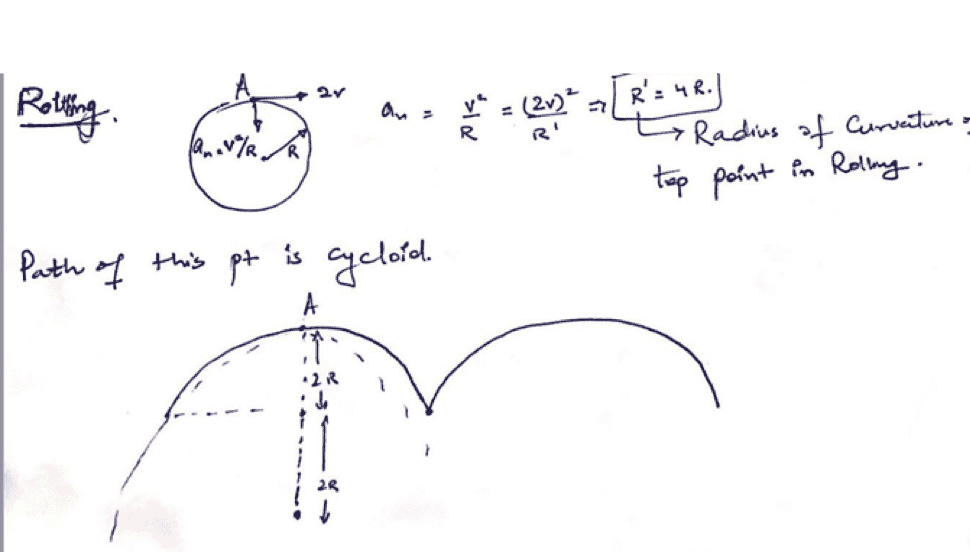

I'm really disappointed with this discussion. So many voices, none contributing anything useful. This forum should be by physicists who know math.
What we have is a curvature of a cycloid, a purely mathematical problem. Here is how to deal with it.
To begin, pick a frame of reference. The geometry is purely 2-dimensional and we need only x and y coordinates.
I choose the origin at the centre of the cylinder and the x-direction along the direction of the movement of the cylinder.
Let me denote the position of the axis of the cylinder as u and the radius of the cylinder as R. Since the cylinder rotates, the angle of the cylinder (measured from its starting position) will be u/R.
Therefore, the coordinates of the point A (top of the cylinder) will be (u+R sin(u/R), R cos(u/R)). The coordinates of the point B will be (u +R cos(u/R), -R sin(u/R)).
Now, we have x, and y coordinates of the points, It is time to apply the curvature formula as given in my previous post (see the link https://en.wikipedia.org/wiki/Curvature#Precise_definition)
For the point A, the X-coordinate is u + R sin(u/R), therefore, the derivative (with respect to u) is x' = 1 + cos(u/R) and the second derivative x" = - sin(u/R)/R.
Similarity, the Y-coordinate y = R cos(u/R) can be differentiated to give y' = - sin(u/R) and y" = - cos(u/R)/R.
Now, all we have to do is to substitute the above expression into the formula for the curvature. Denoting the radius of the curvature as r (lower case) we have
## \frac 1 r = \kappa = \frac {[ x'y"-y'x"]}{(x' ^2 + y'^2)^{3/2}} ##.
At this point I could substitute the expression for the first and second derivatives into the above formula, then see the value of u to 0 and evaluate. This would be too complex, I will set u = 0, evaluate the derivatives and substitute the values into the expression for the curvature.
Here we go, if I set u = u, x' = 2, x" =0, y' =0, y" = -1/R, therefore, the curvature is
## \frac 1 r = \kappa = \frac {[ 2(-1/R) - 0*0]}{(2^2 + 0^2)^{3/2}} = \frac 1 {4R} ##
Therefore, the radius of curvature of the point A is 4 times the radius of the cylinder !.

It seems to me that @TSny's acceleration/velocity/radius approach gets there and by a rather simpler route.
A's motion can be viewed as a linear velocity plus a rotation about C so its acceleration is rω2=v2/r. This is entirely centripetal.
Its velocity in the ground frame is 2v.
Viewed as a rotation about the centre of curvature, radius R, the centripetal acceleration is (2v)2/R.
Equating the accelerations, R=4r.
For point B one has to be a little careful, being sure to equate only the centripetal accelerations.

The centre of the disc has velocity v, the bottom has velocity 0, so the top has velocity 2v.

Davidllerenav said:
Is it the same that you just said? Because ##\vec v_c## would be the horizontal velocity or the velocity of C with respect to point O, a tangential velocity. ##v_{A/C}## would be the velocity of A with respec to C, the tangential velocity of A, so the velocity of A with respect to O ##v_A## would be the sum of both. Is that what this is saying?
Not quite.
##\vec v_C## is the horizontal velocity of C in the lab frame. Its velocity relative to O would be written ##\vec v_{C/O}##, but since O is stationary (instantaneously) that equals ##\vec v_C##.
The velocity of A wrt O would be ##\vec v_{A/O}=\vec v_{A/C}+\vec v_{C/O}=\vec v_{A/C}-\vec v_{O/C}##
