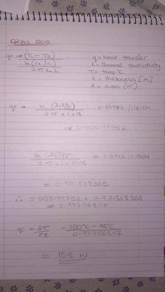

Typed homework problem about a stainless steel pipe with 2.25 cm inner diameter and 1.25 cm wall thickness, covered by 6 cm insulation, with parts (i) and (ii) and a diagram of a circular pipe with a grey insulation ring labelled Pipe and Insulation.
(unsure)
Handwritten derivation on lined paper of a heat transfer rate for a two-layer cylindrical wall, using q = 2 pi k L (T1 - T3) / ln(r2/r1) with sums of thermal resistances, ending with q = (250 C - 95 C) / 0.977065117 = 158 W.
It doesn't look like this has been done correctly. To begin with, the starting equation is incorrect.
For a single layer, it should read:
[tex]2πrLq =Q=2πkL\frac{ΔT}{Δlnr}[/tex]
where Q is the total heat flow (watts) and q is the heat flow per unit area. This equation applies to each of the concentric layers. The problem is analogous to having two resistors in series, where ΔT is like the voltage drop across each layer and Q is the current flow through the resistors. You have to solve for the current flow, given the overall voltage drop across both layers (155 C).
