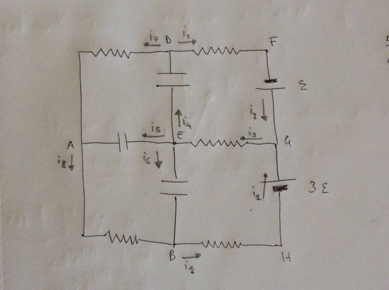

I have to find the charge ##q## on the capacitors (all have capacity ##C= 4 \mu F##) and ##\mathscr{E} = 12 V##, ##R=50 \Omega##
I wrote the nodes current equations
##\begin{cases}
i_{1}+i_{2}=i_{3}\\ i_{3}=i_{4}+i_{5}+i_{6}\\ ...
\end{cases}## etc
But when I write the mesh equations I don't know if the current pass or not through the capacitors (because they are all charged). So how can I write the mesh equations?

Since you say the capacitors are all charged, I think you are looking for the steady state solution. This means, in a DC circuit all the currents and voltages are constant.

If the capacitors are fully charged, then the current through the capacitor is zero. So in your drawing, i_4 and i_6 must be zero (after the capacitors are fully charged).
The rules for solving these circuit problems are:
  1. The current into a node must be equal to the current coming out of the node.
  2. The sum of the voltage changes around any closed loop must be zero.
You have to apply #2 to get the capacitor charges.

So, for example the equation of the loop at the bottom right is ##3 \mathscr{E} - i_{3}R - \frac{q}{C} - i_{1}R=0## ?
And ##i_{5} ## must not be ##0## as ##i_{4},i_{6}##?

Yes.
No. i_5 is zero, also.

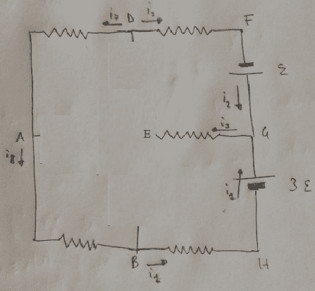

Hi fedecolo,
A handy trick when analyzing the steady-state of a circuit with L and C components is to suppress those components first. That means removing capacitors (open circuit) and replacing inductors with a wire (short circuit).
With the resulting simplified circuit you should be able to determine the potentials at locations where the capacitors were removed and the currents where the inductors were located.
Removing the capacitors from your circuit yields:
Pick a suitable reference node and determine the potentials at A, B, D, and E.

That's the idea. Can you show the details of your calculations for the potentials? They don't all look correct to me.
Ok.
By the equation of the external loop I find ##i_{1}= \frac{\mathscr{E}}{2R}= 0,12 A##
in D: ##3 \mathscr{E} - \mathscr{E} + i_{2}R =V_{D}##
but ##i_{2}=-i_{1}##
so ##V_{D}= 2 \mathscr{E}-i_{1}R= 2 \cdot 12 V - 0,12 A \cdot 50 \Omega = 18 V##
in A: ##V_{D}-i_{1}R= 12 V##
in B: ## V_{A} - i_{1}R = 6 V##
Are they correct?

Yes. You didn't mention that you chose node H as your reference node. That being the case, your calculations are good.
What is the potential at E?

How did you arrive at that conclusion? (hint: No, it isn't zero).

If the current that goes from E to G is zero, what is potential drop across the resistor in that path?

How do you arrive at that conclusion?

Because of Kirchhoff's law the sum of currents that goes in E must goes out from E. So ##i_{3}=0##. So there is no voltage drop at the resistance.
So E is at the same potential of G? If it's ok, the potential is ##3 \mathscr{E}##.

Yes; correct.
