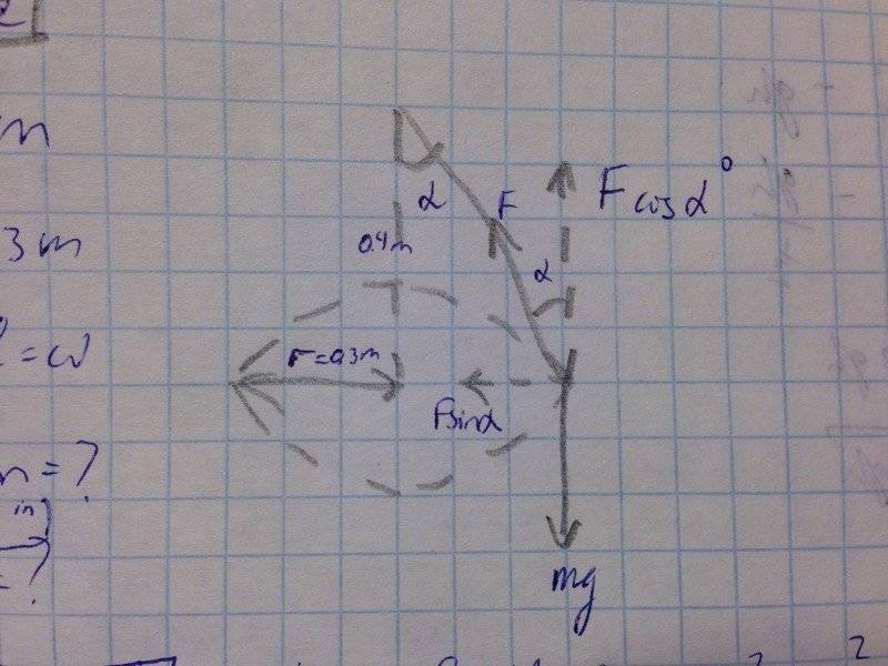

A particle is attached by means of a light inextensible string to a point 0.4 m above a smooth horizontal table. The particle moves on the table in a circle of radius 0.3 m with angular velocity ω. Find the reaction on the particle in terms of ω. Hence find the maximum angular velocity for which the particle can remain on the table
Answers: m (g - 0.4 ω2), √5g/2
2. The attempt at a solution
At first we find the hypotenuse: 0.42 + 0.32 = 0.52 m. Then we find sin α = 0.6 and cos α = 0.8.
The maximum angular velocity is:
R cos α = mg (vertical)
R sin α = mω2r (horizontal)
R = mg / 0.8 and R = mω2r / 0.6
mg / 0.8 = mω2r / 0.6
0.6 mg = 0.8 mω2r
g = 0.4 ω2
ω = √5g/2 or 5 rad s-1 (if g = 10).
Though I don't know where to start with "Find the reaction on the particle in terms of ω." Isn't it R sin α = mω2r → R = 0.5 mω2?
Update:
We have R = 0.5 mω2 and R = mg / 0.8
0.5 mω2 = mg / 0.8
0.4 mω2 = mg
0 = mg - 0.4 mω2
0 = m (g - 0.4 ω2)
It does fit the answer, but I don't quite understand how zero (0) represents "the reaction on the particle". Any ideas please?

Did that. This is what I have:
I am not sure what "reaction" means in this context. From the wording, I guess that it is the normal force exerted by the table. It goes to zero when the mass is just about ready to lift off the surface. You need to write Newton's 2nd law in the horizontal and vertical direction and include the normal force in the vertical direction and the components of the tension in the vertical and radial directions.
On edit: When I posted, the drawing was not available. You need to include the normal force in the vertical direction, not just the component of the tension.
You mean this kind of normal force?
What is the meaning of your last equation? for the record.

Look at your drawing. Is the entire force F opposing the weight mg? If not, how much of F opposes mg? Same thing in the horizontal direction. What piece of F provides the centripetal acceleration?
F cos α opposes mg (vertical) and F sin α opposes mω2r.

As gleem wrote, it is better to think of it as Fw = mg which is equal to (as you said) F cosα. If you put these two together what do you get? Likewise, put together Fr = mω2r and Fr = F sin α.
If we put Fr = mω2r and Fw = mg together we have F cos α = mg and F sin α = mω2r
mg / cos α = mω2r / sin α
mg sin α = mω2r cos α
g sin α = ω2r cos α
Can you solve this for ω which is one of the questions in the problem?
Knowing ω, can you find F, which is the other question?

F = mω2r / sin α is what you're looking for. It is an expression that gives the reaction force F in terms of ω.

I see what's going on now. So far what you have called F is the tension in the string. The solution for F in the previous post is the solution for the tension when ω is at the threshold value and the mass is about to lift off, i.e. when the normal force N is zero. To answer the first question correctly, you need to include the normal force N in addition to the tension F and the weight mg in your diagram as I suggested in post #4. The reaction force that the problem is asking you to find is N and goes to zero when ω is at the threshold value. So you need to rewrite the vertical equation to include N. The horizontal equation remains unchanged.
Hm, how would it look like? I mean shall I just write "N = normal reaction" just under F cos α on the graph?
F cos α + N = mg?
F sin α = mω2r
It gets F cos α + N = mg and F sin α = mω2r so F = (mg - N) / cos α and F = mω2r / sin α
(mg - N) / cos α = mω2r / sin α
(mg - N) sin α = mω2r cos α
ω = √ [(mg - N) tan α] / mr
