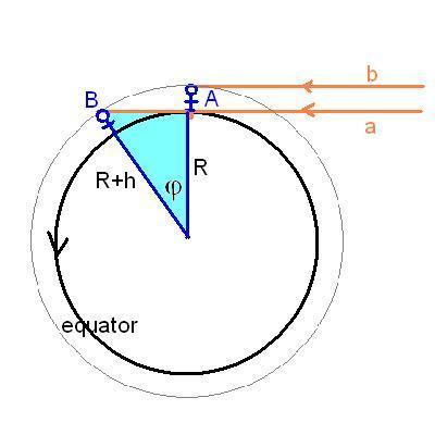

Suppose that, while lying on a beach near the equator watching the Sun set over a calm ocean, you start a stopwatch just as the top of the Sun disappears. You then stand, elevating your eyes by a height H = 1.70 m, and stop the watch when the top of the Sun again disappears. If the elapsed time is t = 11.1 s, what is the radius r of Earth?
Use the celestial sphere to solve the problem.

I always get to the this equation, R+1.7cos0.04625=R, and Have no idea what to do from there.
Add parentheses at the proper places? Your equation means that 1.7 cos0.04625=0 which is obviously wrong.
For better understanding, I attach the missing figure. One sees the sunset when the ray arriving to the eye from the sun is tangent to the Earth.

wow I am retarded lol. Thx ehild, now i get it
