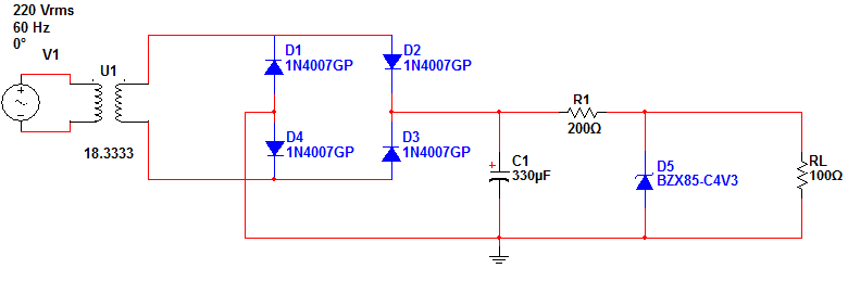

Hi, Everyone.
I'm doing an AC to DC converter circuit using rectifier, filter capacitor and zener shunt regulator, to provide an output DC voltage of 4.3V. I designed the circuit in several steps, which I have attached in a PDF file. Here's the final circuit:
When I do a Multisim simulation, the output voltage across the 100Ω load is 4.257V, which is a good thing anyway because the error% is small. However, when I assemble the circuit in reality on a breadboard, the output is 3.95-3.98V, which is really far less than the required output. The question is, where is the problem in the design?
I hope you can check the design calculations in the attached PDF file, and I would be pleased to take your notes.
Thanks.
I think you should check your zener diode.
I replaced it with another one, and it's the same. Nothing changed!
Fairchild datasheet for the diode says it'll be 4.0 to 4.6 volts at IZ of 50 milliamps.
You are pushing ~ 50 ma through your 200 ohm resistor
and 4 volts will push 40 of those through your 100 ohm resistor
leaving only 10 through the zener.
So the zener is low on current.
Sanity check: Zener is 13 ohms at Iz(50 ma) and 40 ma X 13 ohms leaves you 0.56 volts short. You measured half that. Not bad for a nonlinear device.
I'd say your zener current is low.

From your post, I understand that I need to assume a bigger value for IZ(Min) so that I can end up with a lower resistance value and a bigger capacitance value, hence more current will flow through the resistor, R. Assuming a bigger value for the minimum current through the zener diode, would guarantee that the zener will have enough current to breakdown somewhere between 4.0-4.6V. Is that correct?
something like that.
i didnt follow step 6 where you calculated 194 ohms then ~'d it to 300
but i think the discrepancy is in using 13 ohms for Rz at 10 ma.
Spec sheet says it's 13 ohms at 50 ma and 500 ohms at 1ma ,
so at 10 ma it'll be somewhere in between.
Remember that's a dynamic impedance, the slope of the I/V curve at anyone point.
1 watt at 4.3 volts would be 232 milliamps
and they specified 13 ohms ar 50 ma which is 21% rated. Probably middle of its good regulation regime.
Your 10 ma is only 4% rated, not far from the knee actually. It'll regulate better in 10-70% range.
Semtech suggests IZmin in 5 to 10% range .
http://www.google.com/url?sa=t&rct=...xr87q9wPS_qo-tfsw&sig2=T14YmtGaQfDf2jDXbEnoLQ
Since you have it breadboarded why not just just briefly lift the 100 ohm resistor , forcing all 50 ma through the zener ? What's its voltage then?

Did you consider a three pin voltage regulator? The designers will have taken care of all those grisly details.
Shunt zener regulators are a bit prone to getting hot and they 'waste' current if you need substantial power out of them.
