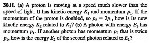

For part b), I can see that, as p = \frac{E}{c}, then a photon with twice the momentum must have twice the energy. However, I cannot see the answer to part a). My book states that k_2 = 4k_1, but I would have thought that, as per the answer to b), the KE is just twice that of the other, not four times?
The particle in part A is a proton, not a photon.
And since it traveling at a speed much lower than c you can just use classical mechanics.
Oh wow... All this reading about photons has me seeing the word everywhere -_-
Thank you very much :)
