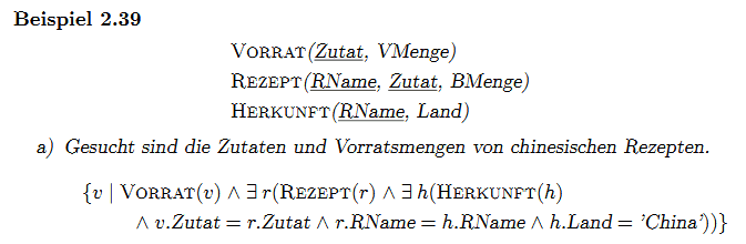

As for the tuple calculus I found ine the notes the below example :
So at 1 we have then $$\{(k.KUNDNR, k.ORT)\mid \left (\text{KUNDE}(k)\right \}$$ or not? :unsure:
Yep. Looks correct to me. (Nod)

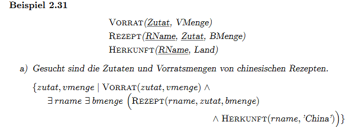

I found relational algebra that shows sets with tuples and also the use of e.g. $\text{KUNDE} \ltimes \text{AUFTRAG}$. 🤔
I am looking these notes (they are in german). From pdf-page 20 we have relational calculus and from pdf-page 23 we have tuple calculus. 🤔
  • #41
It says that the following is "Bereichs-Kalkül", which I think means Domain Calculus.
And it says that the following is tuple calculus.
It doesn't seem to refer to joins and such ($\Join$), so perhaps those are not intended to be used.
Either way, I guess we need to express each problem both as Domain Calculus and as Tuple Calculus. 🤔
