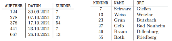

The below relations are given AUFTRAG($A_1, A_2, A_3$) and KUNDE($B_1, B_2, B_3$) with $A_1$ = AUFTRNR, $A_2$ = DATUM, $A_3$ = KUNDNR, $B_1$ = KUNDNR, $B_2$ = NAME and $B_3$ = ORT.

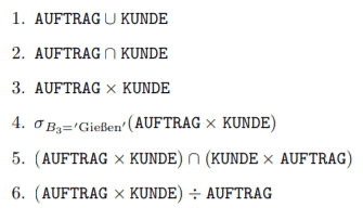

Determine the below sets or justify why it is not possible to determine them.

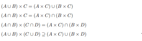

Let $A = A_1 \cup A_2 \cup A_3$ and $B = B_1 \cup B_2 \cup B_3$. Check if the below hold.
In a previous exercise I have shown the below relations (I suppose that they are useful here) :
I have done the following :
1. It holds that $\text{AUFTRAG}\cup \text{KUNDE} = (A_1, A_2, A_3)\cup (B_1, B_2, B_3)$. Since $A_3$ and $B_1$ are not entirely distinct we can use the first property, can't we? Or isn't this correct because these sets are notat the same position at the respective tupel? :unsure:
2. It holds that $\text{AUFTRAG}\cap \text{KUNDE} = (A_1, A_2, A_3)\cap (B_1, B_2, B_3)$. Here we can use the third property and so it holds that $\left (A_1\cap B_1 , A_2\cap B_2 , A_3\cap B_3\right )$, right? :unsure:
3. It holds that $\text{AUFTRAG}\times \text{KUNDE} = (A_1, A_2, A_3, B_1, B_2, B_3)$, or not? So we take all posible combinations for that set, don't we? :unsure:
4. We take the result of 3 and we replace $B_3$ everywhere by "Gießen", right? :unsure:

1. It holds that $\text{AUFTRAG}\cup \text{KUNDE} = (A_1, A_2, A_3)\cup (B_1, B_2, B_3)$. Since $A_3$ and $B_1$ are not entirely distinct we can use the first property, can't we? Or isn't this correct because these sets are not at the same position at the respective tupel?
Hey mathmari!
What do you mean by $(A_1, A_2, A_3)$ exactly? 🤔
I believe that e.g. $A_1$ is the set of all AUFTRAG numbers.
Strictly speaking $(A_1, A_2, A_3)$ would then be a tuple of 3 sets, which would be a single element of an unnamed set. (Worried)
Or did you mean $AUFTRAG=\text{AUFTRAG}(A_1,A_2,A_3)\subseteq A_1\times A_2\times A_3=\{(a_1,a_2,a_3)\mid a_1 \in A_1,a_2\in A_2, a_3\in A_3\}$?
Is $(A_1, A_2, A_3)$ perhaps a shorthand for the same thing? (Wondering)

These are incompatible tupels, but that is okay for a set. We just have a set of different types.
Each tupel in AUFTRAG is a single element. None of these tupels occur in KUNDE, do they? 🤔

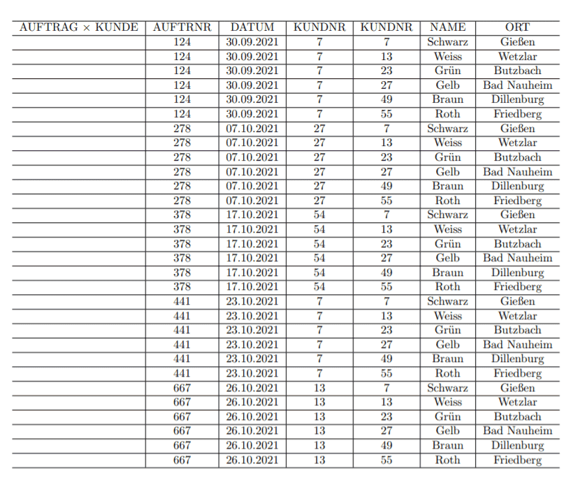

I believe we need to match each row in AUFTRAG with each row in KUNDE and write them as 6-tupels. 🤔
I believe we are supposed to take the subset of the result of 3 of the tupels that have "Gießen" in them.
The symbol $\sigma_{condition}$ means SELECT WHERE condition.

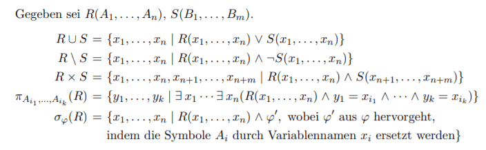

We have that AUFTRAG and KUNDE are relations.
For the union of the relations $R$ ans $S$ with $R(A_1, \ldots , A_n)$ and $S(B_1, \ldots , B_m)$ we have $$R\cup S=R'(A_1, \ldots , A_n)$$ that is produced by $$R'=\{t\mid t\in R\lor t\in S\}$$
For the cartesian product we have $$R\times S=R'(A_1, \ldots , A_n, B_1, \ldots , B_m)$$ that is produced by $$R'=\{r\cdot s\mid r\in R\land s\in nS\}$$ where $r\cdot s=(r_1, \ldots , r_n, s_1, \ldots , s_m)$ when $r=(r_1, \ldots , r_n)\in R$ and $s=(s_1, \ldots , s_n)\in S$.
So that means that we get $$\{(124, \ 30.09.2021, \ 7, \ 7, \ \text{Schwarz} \ , \ \text{Gießen}), (124, \ 30.09.2021, \ 7, \ 13, \ \text{Weiss} \ , \ \text{Wetzlar}), \ldots \}$$ right? :unsure:
So we take the elements of $\text{AUFTRAG}\times \text{KUNDE}$ that has the element "Gießen" as the last component, right? :unsure:
Good. (Nod)
But what is $(A_1, \ldots , A_n)$? 🤔
Note that $R(A_1, \ldots , A_n)$ means that we have a relationship $R$ that is a function of the sets $A_1$ up to $A_n$, which is different from a tupel of sets. 🤔
Correct. (Nod)
Yep. 🤔

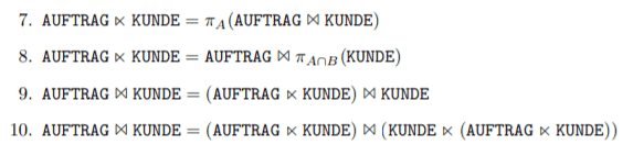

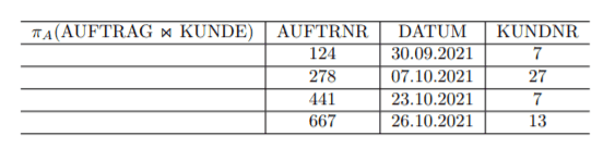

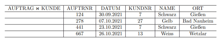

At 7 the left side is the elements of AUFTRAG that have the as KUNDNR numbers that occur also in KUNDE right?
At 7 the right side is the first three columns of the result of the parenthesis, right?
At 9 the left side is a kind of concatenation of the elements of AUFTRAG that have the as KUNDNR numbers that occur also in KUNDE right?
:unsure:
Yes to everything. (Nod)
They are called a left semijoin ($\ltimes$), projection ($\pi_{a_1\ldots a_n}$), respectively natural join ($\Join$). (Nerd)

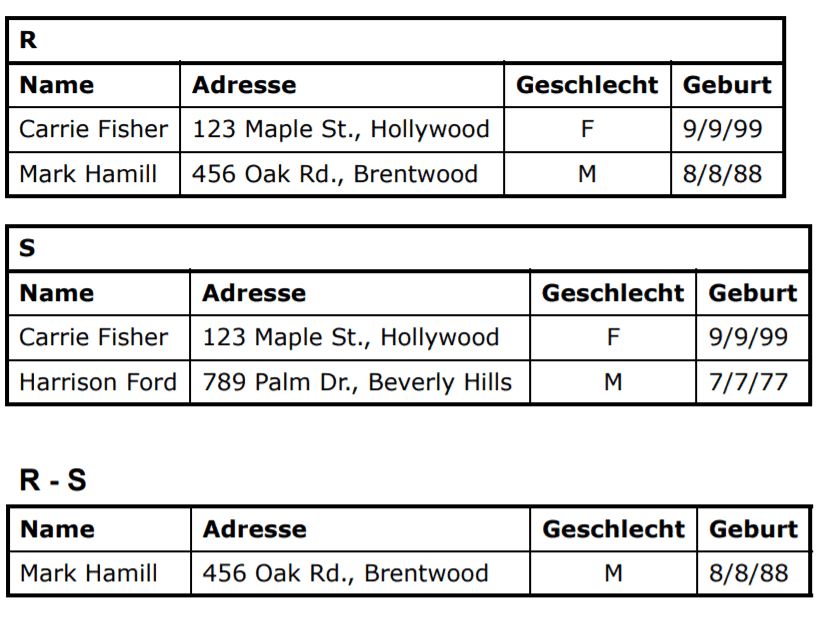

The prerequisite for the union of $R$ and $S$ is their compatibility, i.e., Rank (R) = Rank (S) and for all $i = 1, 2,\ldots , n$ it should hold that dom($A_i$) = dom($B_i$).
What exactly does that mean? Are these conditions satisfied in this case? :unsure:
mathmari said:
I read now in the notes :
It means that R and S must have exactly the same column headers. 🤔

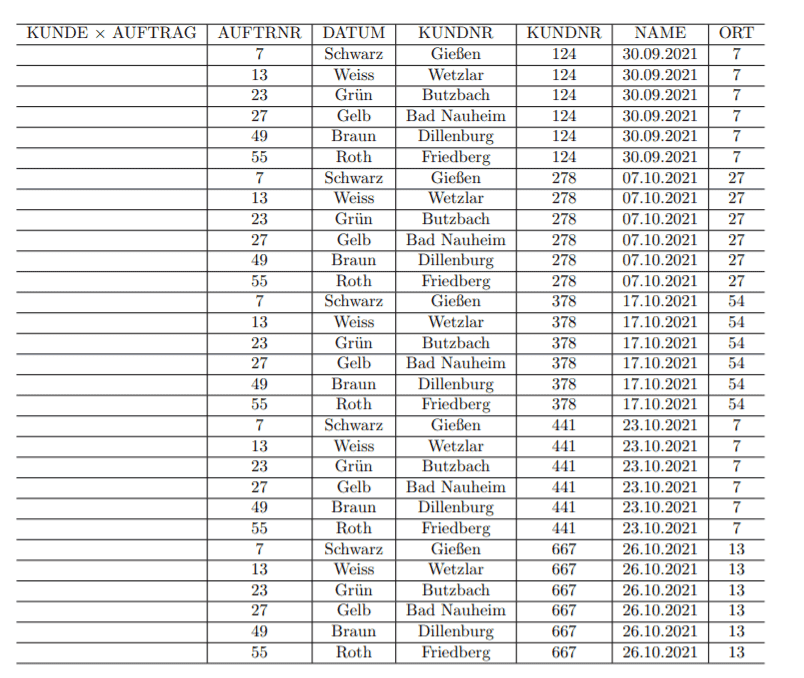

mathmari said:
Question 5 :
This does not look correct. The data in the rows does not match the column headers.
The column headers should be first the ones from KUNDE and then from AUFTRAG. (Worried)
mathmari said:
Perhaps there is a note about this?
It may have been intended that if the columns are ordered differently, that the rows still match. 🤔
mathmari said:
Question 6 :
https://www.physicsforums.com/attachments/11403
So it is the same as KUNDE.
I think so yes. (Nod)

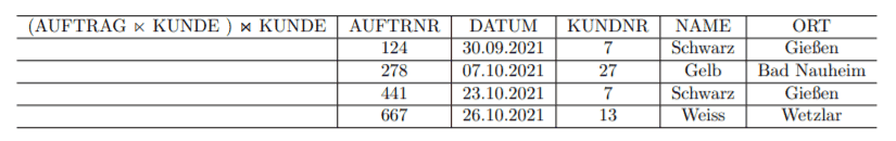

Ah I didn't change the titels of the columns... So do we have the following :
About the intersection we have $R\cap S=R\setminus (R\setminus S)$. That means that (AUFTRAG $\times$ KUNDE) $\cap$ (KUNDE $\times$ AUFTRAG) is the table of (AUFTRAG $\times$ KUNDE) without the columns of (KUNDE $\times$ AUFTRAG) and then we consider the table of (AUFTRAG $\times$ KUNDE) without the columns of the previous result, right? :unsure:

For question 5, we have that AUFTRAG $\times$ KUNDE and KUNDE $\times$ AUFTRAG have the same columns although in a different order, and they also have the same rows.
The corresponding $R\setminus S$ has no columns nor rows at all. It is the empty set. When we subtract that again from $R$ we simply have $R$.
So I believe that (AUFTRAG $\times$ KUNDE) $\cap$ (KUNDE $\times$ AUFTRAG) = AUFTRAG $\times$ KUNDE. 🤔

We consider the relations AUFTRAG and KUNDE and create an expression for each of the below from the algebra of relations.
1. Create an expression that lists all possible combinations of customer numbers (KUNDNR) and locations (ORT).
2. Create an expression that lists all customer names (NAME) with at least one order (Auftrag).
3. Create an expression that lists all order numbers (AUFTRAGNR) with customers from Gießen or Wetzlar.
4. Create an expression that lists all customer numbers (KUNDNR) without an order (Auftrag).
5. Create an expression that lists all customer numbers (KUNDNR) that are not assigned to any order (Auftrag) and all customer numbers (KUNDNR) to which no name (NAME) is assigned.Do we have the following ?
1. $\pi_{\text{KUNDNR}, \text{ORT}}(\text{AUFTRAG}\times\text{KUNDE})$

Note that $\text{AUFTRAG}\times\text{KUNDE}$ consists of the combination of every possible row in AUFTRAG with every possible row in KUNDE - even if they don't match. (Worried)
Moreover, I think $\sigma_{B_3=`\text{Gießen'}, B_3=`\text{Wetzlar'}}$ means to select on $B_3=`\text{Gießen'} \operatorname{AND} B_3=`\text{Wetzlar'}$, which will then result in an empty set as they are mutually exclusive. (Worried).

The difference $R \setminus S$ deletes the tuples from the first relation that occurs also in the second relation.
An example :
An example :
That seems to imply that we require that both relations have the same columns, or it won't be defined.
Is that the case? :unsure:
