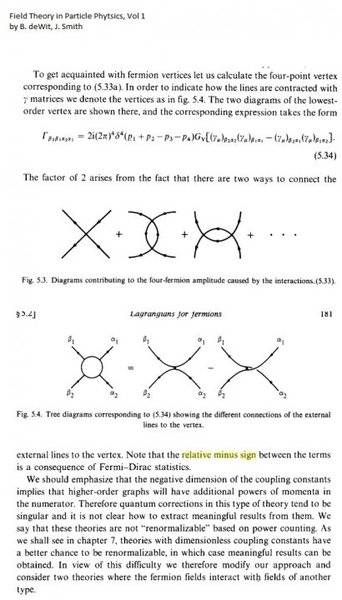

Consider the scattering process ##W^{+}W^{-} \to W^{+}W^{-}##. This process is mediated in the Standard Model by
1. a four-##W## scattering,
2. ##Z##-boson exchange,
3. Higgs exchange.
Let us consider the diagrams for ##Z##-boson exchange:
Why is there a relative minus sign between the matrix elements for the two diagrams?
Newbie here...have you considered that the relative minus sign btwn two terms is dictated by the Fermi-Dirac stats? something about a possible closed loop - which carries the extra minus sign.
I hope this helps.
Deneen
Could you be more specific?
how can you use Fermi-Dirac statistics for W/Z bosons?
Also I think that that minus sign mentioned in your reference appears between t- and u- channels...
@spaghetti3451 Could you explain why you think there should be a relative minus in the first place for this process? There is no u channel process here in the case of a Z mediator.
