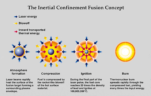

She could make a fun demonstration project that doesn't actually cause any nuclear reactions, but illustrates some characteristic of fusion or fission.
For example, she could put together a setup with some number of mechanical piston actuators arranged in a sphere so that when you drop a ping-pong ball down into it, it triggers and squishes the ball spherically. This would be intended to illustrate Laser ICF. She would need to have some timed trigger/sensor mechanism that senses when the ball reaches the center, and triggers the solenoids or other actuators to fire all of the pistons inward simultaneously.
She would write up a paper or poster presentation on ICF and how it works, and included details of where the current projects like NIF are in their timelines... :smile:
https://chemconnections.org/crystals/icf.html
