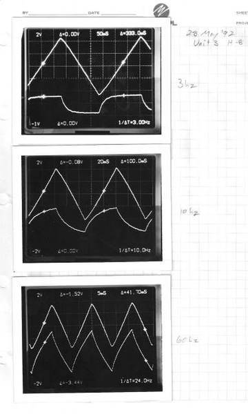

I'm no magnetics expert either, but have experimented a little. Here's some tangential experience that might help formulate your ideas...
Baluncore's point about iron not magnetizing instantly is significant. Magnetization of a solenoid core proceeds from the outside in, slowed by eddy currents. In my 1901 textbook it's called "Retardation of Magnetization" and could amount to minutes in large railway dynamo poles of the day.
To observe it one can place two coils around a core, energize one and use the other as a flux detector. Induced voltage in the flux detector coil should be di/dt of the exciting coil current. The flux detector coil can be connected to an integrator to produce a flux signal that's observed on an oscilloscope. Using a sinewave excitation current, one will see sinewave flux. Interestingly, one will see retardation as phase difference between current and flux. I started with a home-made integrator that wasn't very good, and looked at Lissajous patterns on the 'scope. Results were confusing so we moved to approach in next paragraph.
Lacking a practical integrator, one can excite the first coil with a current signal whose derivative is known, and observe the induced voltage in detector coil. Any deviation from expected is due to something going on in the core.
With sinewave excitation current you'll just see sinewaves not in phase and it's not intuitive what's happening.
But driving with let's say triangle wave current, which has for its derivative a square wave, things look more interesting.
Here's photos of a 12 foot tall core surrounded by two coils, one excited by triangle waves at three different frequencies- 3, 10, and 60 hz.
In each photo top trace is current (20milliamps peak to peak) and bottom is voltage induced into detector coil.
Triangle current through an inductor should produce square wave voltage.
Observe that this core is mighty slow. You can see in the first photo that the corners of the 3hz square wave are rounded off. At higher frequency retardation becomes the dominant effect.
But removing the core gave nearly ideal looking square waves , even at 60 hz..
So the inductor was "ideal" until we gave it a core.
So I'm suggesting you have some fun poking at sample core materials with known MMF's. Above is an easy method that's quite graphic.,
