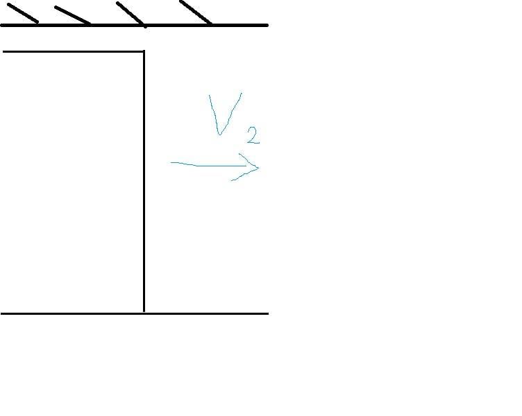

And here is my second question:
Hand-drawn sketch of a compressor section: a horizontal hatched support at top, a rectangular duct outline, and a blue arrow pointing right labelled V2 at the outlet side.
How gas with velocity V2 can act on compressor when it is after the last rotor/stator in the compressor?
I understand when gas with velocity V2 hits the last rotor/stator leading edge, it exerts than force which pull the compressor from left to right, but how gas which is after the last blade can affect the compressor?

In my judgement, this problem is analyzed totally incorrectly. This problem should be solved using a macroscopic momentum balance on the fluid in the control volume between the compressor inlet and exit. This will tell you the horizontal force that the compressor is exerting on the fluid, which is equal and opposite to the horizontal force that the fluid is exerting on the compressor.
At the inlet and outlet to the control volume, what is the force acting on the fluid? At the outlet of the control volume, what is the force acting on the fluid? What is the rate of momentum flow into the control volume? What is the rate of momentum flow out of the control volume? Let F be the horizontal force that the compressor exerts on the fluid. Write a macroscopic momentum balance on the fluid in the control volume, including the force F. Let's see what you come up with.
