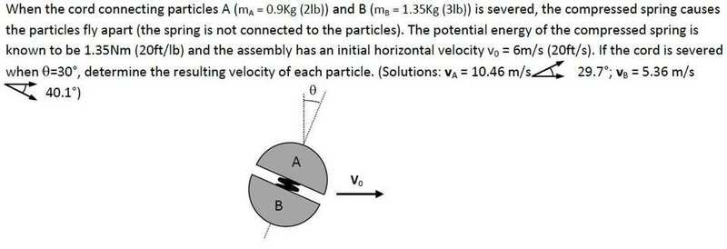

[solved] resulting velocity of 2 particles
conservation of momentum
m_Av_A'=m_Bv_B'
v_A'=\frac{m_B}{m_A}v_B'
conservation of energy
V=\frac{1}{2}m_A(v_A')^2+\frac{1}{2}m_B(v_B')^2=\frac{1}{2}m_A\left(\frac{m_B}{m_A}v_B'\right)^2+\frac{1}{2}m_B(v_B')^2
v_B'=\sqrt{\frac{2m_AV}{m_B(m_A+m_B)}}
m_A=0.9Kg
m_B=1.35Kg
V=1.35Nm
v_B'=\sqrt{\frac{2\cdot0.9\cdot1.35}{1.35(0.9+1.35)}}=\sqrt{0.8}\approx{0.8944[m/s]}
v_A'=\frac{1.35}{0.9}\cdot0.8944=1.3416[m/s]
from the law of cosines
v_B=\sqrt{6^2+0.8944^2-2\cdot6\cdot0.8944\cdot\cos{60^o}}\approx5.607[m/s]
from the law of sines
\sin{\beta}=\frac{\sin{60^o}\cdot0.8944}{5.607}\approx0.1381
\beta\approx7.94^o
As you can see that result is totally different from the solution given by my teacher. I also get different results for the other velocity. So either my calculations are incorrect or my teacher gave us wrong results. I'll be grateful for any help, thank you.
disclaimer: Nice work. Your answer for vB, 5.6066 m/s at -7.9413 deg, is correct. The solution of your teacher is wrong.
We can see that the solution of your teacher is impossible, because in the solution of your teacher, the final kinetic energy of particle A greatly exceeds the total initial energy of the system, which would violate conservation of energy.
Thanks for your reply, nvn. Actually I figured out where my teacher made a mistake. Obviously he didn't multiply 1.35Nm by 20 while converting the unit from ft*lb.
1{ft}\cdot{lb}\approx1.355817456Nm
That said, if I assume the potential energy to be 27Nm, then my results are almost the same as those given by my teacher.
I interpreted what you wrote as meaning, "Obviously, he didn't multiply 20 ft*lbf by 1.35582 N*m/(ft*lbf) while converting from ft*lbf."

And here is one more mistake by your teacher.
(6) ft/lbf is a unit of flexibility, not work; work is ft*lbf, or N*m, or J.
