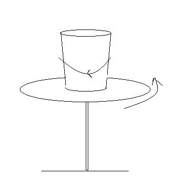

Considering the above set-up, we have a platform that rotates with some angular velocity with respect to the earth. And on this platform, a magical bucket (filled with water) rotates with the same angular velocity, but in the opposite direction.
Now, on the Earth frame, anyone looking at the bucket will see that the bucket and hence the contained water is not rotating, hence the shape of the water will be flat.
However, if a person were to stand on the rotating platform, they would see the bucket rotating, hence the water should appear as concave. (Would the centrifugal force observed in the reference frame of the spinning platform cancel the effects of the rotating bucket on the water, such that the net effect is that the water appears flat in this frame as well?)
How can these two different conclusions be reconciled?
Rotation in GR is not Machian. You can tell whether your laboratory is rotating without reference to anything external. Some ways you can tell are: (1) a gyroscope, (2) the Sagnac effect, or (3) the bucket of water you described.
GR does, however, allow you to use any coordinate system you choose. If you want to use a rotating coordinate system, you can. In that coordinate system there will be a gravitational field away from the axis. In a frame rotating with the water, this gravitational field is what causes the water to form a concave surface.

The water in the bucket will be flat for both observers. The bucket is stationary relative to the stars and the person on the rotating platform is not. The person on the platform will experience non linear acceleration hence they will know they are rotating and they will also know that even thought the bucket is seemingly rotating, in reality it is not rotating at all regardless of who is looking at it.
I don't agree. If it seems, for the person on the rotating platform, that the bucket is rotating, then it follows that they must see the water in the bucket forming a concave shape.
For an observer standing on the earth, he sees the bucket and its contents as being completely still. So then how can the water be both flat and concave depending on where we look at it from?
I understand that if we "look for a centrifugal force" in the frame of the rotating bucket, we will find one and therefore conclude that the bucket is spinning. The same applied to the rotating platform would lead to the conclusion that the platform is spinning as well.
My question is how I can reconcile the conclusion that the water is both flat and concave, depending on where it is observed from.

You have missed what everyone is telling you - rotation is not relative.
Have you tried this ? If the bucket is not rotating, then all observers will see the water surface flat. The water acts as a 'rotatometer', and tells us if the bucket is rotating.
I think his question is: why in the universe is there a "rotatometer" but not a "speedometer" ?
The answer is because rotation is made by pair of differential inertial frames (pairs of frames moving at +v and -v).

The water would be concave because it is spinning. The point is that if the water, or anything, is rotating, this is not relative. The forces created locally by the rotation make the surface concave.
