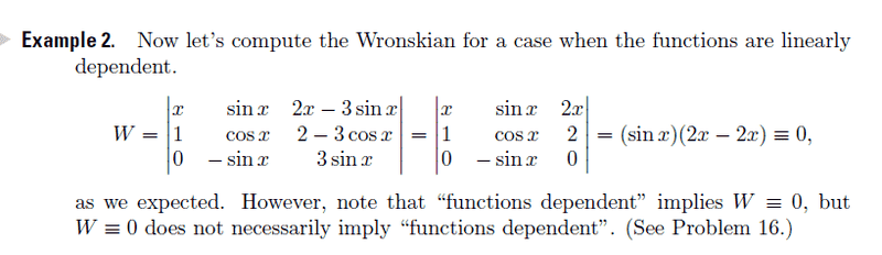

What is the process for rewriting the third column? 2x-3 and be rewritten as 2x, and 2-3cosx can be rewritten as 2.
I don't get this.

They are adding 3 times the second column to the third.
