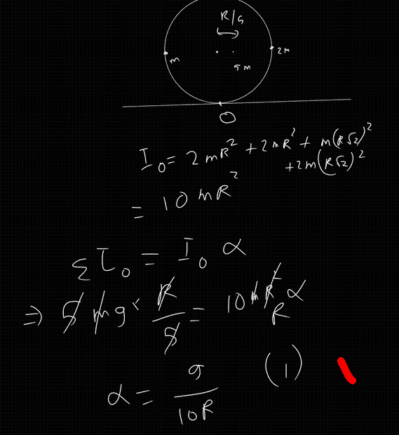

Can you not calculate ##I_O## separately for each of the three parts of the system? Then, $$I_O^{\text{(system)}}=I_O^{\text{(2m)}}+I_O^{\text{(m)}}+I_O^{\text{(ring)}}.$$
What is ioring here
Sorry for asking but could u pls tell how to do the next part? Just say by words, I will find out the equatiosn
palaphys said:
What is ioring here
It is the moment of inertia of the ring about bottom point O. Use the parallel axes theorem to find it.

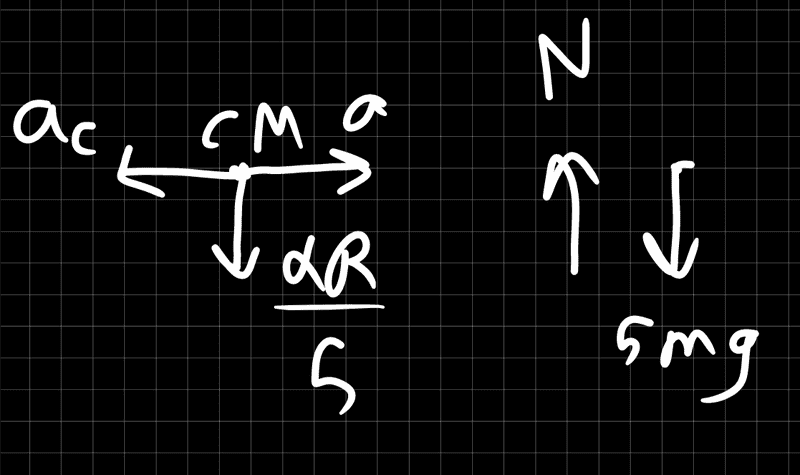

palaphys said:
You mean fbd of cm?
The center of mass is a geometrical point on which only gravity acts. You need a FBD in which you can put the forces that you need to find, friction and the normal force. What do you think you should draw a FBD of?
Center of mass the 5m thing?
But isn't the center of mass accelerating tangentially as well here? Pls help. What else to draw fbd of?

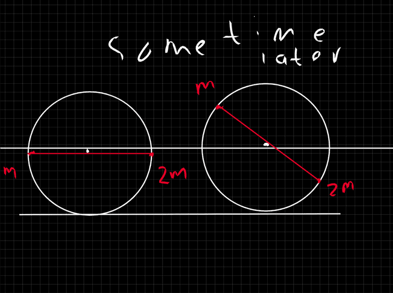

palaphys said:
i cannot think about how the center of mass is moving here
Have you seen bicycles with reflectors on the spokes of their wheels? Imagine a reflector at distance ##\frac{1}{5}R## from the axis of the wheel. The path that it describes as the bicycle moves forward is a cycloid. That's the path of the CM here.

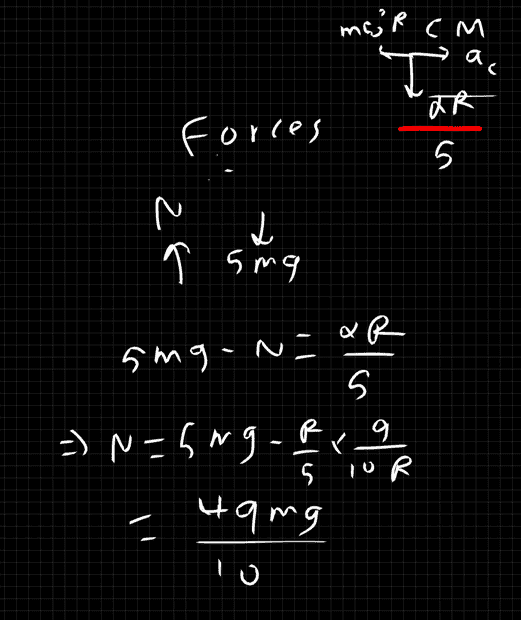

You have not provided so far the final answer for the angular acceleration in part (a). Please do before worrying about the force of friction. That's because your plan of attack should be to find the magnitude of the linear acceleration of the CM and from it the horizontal component of the acceleration of the CM.
Ok. I assume cycloid is some kind of curvilinear motion. Now in GENERAL rolling cases, where the center of mass is the geometric center, it just goes in a straight line right?. So I feel that the center of mass here may have two accelerations, namely linear and tangential. Am I right?

Oh so you are saying that here as center of mass moves forward, it is due to friction?
If you would draw a FBD you should be able to see that if the wheel is accelerating to the right, there is some force acting to the right. What force can act to the right? Which way is normal force. Which, direction are the weight forces, is anyone pushing the wheel etc... are questions you should be asking yourself. At the very least by process of elimination you should see that there must be a horizontal force, and where it must act.
palaphys said:
... as center of mass moves forward, it is due to friction?
... and to the imbalance of masses around the ring: that is the driving torque.
If you take your point of view as the center of the ring, you will see the ring pushing the surface rearward.
In order to do that, the ring needs "to be able to grab" onto the surface.
But will friction not cause angular retardation if it acts towards the right? Then how will the no slip condition be maintained?
