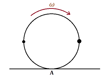

I'm so close to finishing this, just gotta clarify that major thing whether the IAR is an inertial frame
A frame is more than just a point (IAR=instantaneous axis of rotation, I assume). There are also the matters of directions and acceleration.
The point of the ring that is instantaneously in contact with the ground is accelerating, but the fixed point on the ground it is currently in contact with is not.
You could also mean the contact point as a dynamic entity, neither fixed on the ground nor fixed to the ring. In that case it would be inertial if the ring were rolling at constant velocity, but in the present case it is accelerating.

It wasn’t a definition. It was a factual statement about the direction in which the forces we call static friction and kinetic friction both act. Whether that is pure coincidence or arises because of a common underlying cause may be a research topic but is not important here.
The equation ##\large \sum \tau_{A} = I_{A} \alpha## yields the correct answer for ##\alpha## for this particular problem. But, in general, this equation is not valid. For example, if the ring has angular velocity ##\omega## at the instant shown below, then ##\sum \tau_{A} = I_{A} \alpha## will not work for finding ##\alpha## at this instant.
However, taking torques about the center of mass of the system will work: ##\large \sum \tau_{cm} = I_{cm} \alpha##.
This is already a long thread and I hesitated to post this. But I want to caution students that ## \sum \tau_{A} = I_{A} \alpha## is not generally correct.
If you want to use point ##A## as the origin for torques, then the valid equation is ##\sum \tau_{A} = \dfrac {dL_A}{dt}##, where ##L_A## is the angular momentum of the system about ##A##. But, generally, ##\dfrac {dL_A}{dt} \neq I_A \alpha##.

haruspex said:
How about if we distinguish the angular acceleration about A (as a fixed point on the ground) from that about the centre, ##\alpha_A=\alpha_C+a/R##? Is ##\tau_A=I_A\alpha_A## ok?
I'm not familiar with defining different ##\alpha##'s this way. So, I don't know.
For the problem of post #123 where the ring is already rolling with angular speed ##\omega## in the figure, I find the angular acceleration at that instant to be ##\alpha = \frac 1 {10}(\frac {g}{R} + \omega^2)##. If you have time, you could try your idea and see what you get.
So I just went through the official question once more and it says that the ring starts from rest. All the values which have been asked to he computed are at the instant just after it begins to roll. So here I don't think there is much of a problem whether the bottom most point is inertial

palaphys said:
It's not rolling initally
Yes, I understand. For the case where the ring is initially at rest, the formula ##\sum \tau_A = I_A \, \alpha## happens to give the correct answer for the initial value of ##\alpha##. However, this equation does not hold at instants of time when the ring is in motion. So, I don't think it's a good idea to promote the use of this formula.
However, it can be shown that the formula ##\sum \tau_{cm} = I_{cm \,} \alpha## holds at all instants of time during the motion of the ring. You are safer with this formula.
I withdraw that.
But as I wrote in post #121, one has to be careful what one means by "rotating about A”.
Is that the fixed point on the ground which was the initial point of contact, the point fixed to the ring which was the initial point of contact, or, dynamically, the point on the ground currently in contact?
Only the first of the three can be the origin of an inertial frame. The other two are accelerating.
Generally, it is safe to use the mass centre for the axis or any inertial frame. I believe it is also ok to use a point that is accelerating directly towards or away from the mass centre since that does not alter the angular acceleration about the point.
E.g. consider masses m, 2m at opposite ends of a seesaw length 2R. If we use a point below the middle but accelerating up at rate a, the apparent rate of change of angular momentum is ##2m(aR+\alpha R^2)+m(-aR+\alpha R^2)=maR+3m\alpha R^2##, but the torque is still ##mgR##.

Well, I got a different answer for the initial angular acceleration... So what goes wrong here.
I find ## \alpha = \frac{25}{51}\frac{g}{R} ##
Here is what I did:
$$ x = R \theta + (\cos \theta - 1) r $$
$$ y = -r \sin \theta$$
The derivates follow as:
$$ \ddot x = R \ddot \theta - r \left( \dot \theta^2 \cos \theta+ \ddot \theta \sin \theta \right)$$
$$ \ddot y = r \left( \dot \theta^2 \sin \theta - \ddot \theta \cos \theta \right) $$
Where ##r = R/5##, but leaving it general for now.
I get three equations of motion
##\sum F_x##
$$ f = M \ddot x $$
##\sum F_y##
$$ N - Mg = M \ddot y $$
## \circlearrowright^{+} \sum \tau_G##
$$ N R \cos \theta - f R = I_G \ddot \theta $$
Where ## M = 5m ##
Now get all the equations into functions of ##\theta## and its derivatives.
$$ \implies N = M r \left( \dot \theta^2 \sin \theta - \ddot \theta \cos \theta \right) + Mg $$
$$ \implies f = M \left(R \ddot \theta - r \left( \dot \theta^2 \cos \theta+ \ddot \theta \sin \theta \right) \right) $$
At this point I just make the substitutions for the initial conditions ## \theta = 0 , \dot \theta = 0 \implies \cos \theta = 1, \sin \theta = 0 ##
$$ \implies N = Mg - Mr \ddot \theta $$
$$ \implies f = MR \ddot \theta $$
Rearrange the last:
$$ \ddot \theta = \frac{f}{MR} $$
And then sub into the sum of torques about ##G##:
$$ f R = MgR - \cancel{MR}r\frac{f}{\cancel{MR}} - I_G \frac{f}{MR}$$
$$ \implies f = \frac{M^2 R^2 g }{MR^2 + MRr + I_G } $$
I find the mass moment of inertia about ##g## to be:
$$ I_G = 2m \left( \frac{4}{5}R \right)^2+ m \left( \frac{6}{5}R \right)^2 + \frac{1}{2} 2m R^2 + 2m \left( \frac{1}{5}R \right)^2 = \frac{21}{25}MR^2 $$
Finally
$$ f = \frac{25}{51}Mg $$
$$ \alpha = \frac{25}{51}\frac{g}{R} $$
Can someone see where I've gone off the rails? Thanks.
EDIT: Errors found-
1) Used wrong moment arm for torque of normal force, should be ##r##.
2) Error in using the wrong model. I used a "disk" when the OP is a "ring"
Fixing the errors verifies solution for ##\alpha = \frac{1}{10} \frac{g}{R}## that has been previously shown.
erobz said:
$$ I_G = 2m \left( \frac{4}{5}R \right)^2+ m \left( \frac{6}{5}R \right)^2 + \frac{1}{2} 2m R^2 + 2m \left( \frac{1}{5}R \right)^2 = \,\, ...$$
The third term on the right should not have the factor of ##\frac 1 2 ## for a ring. Otherwise, it looks good.
I could have sworn it was a disk! Thanks for finding that and your time.
Unfortunately, still no dice...
$$ I_G = 2m \left( \frac{4}{5}R \right)^2+ m \left( \frac{6}{5}R \right)^2 + 2m R^2 + 2m \left( \frac{1}{5}R \right)^2 = mR^2 \left( \frac{32}{25} + \frac{36}{25}+\frac{50}{25}+\frac{2}{25} \right)= \frac{24}{25}MR^2 $$
$$ \alpha = \frac{25}{54} \frac{g}{R} $$
erobz said:
$$ mR^2 \left( \frac{32}{25} + \frac{36}{25}+\frac{50}{25}+\frac{2}{25} \right)= \frac{24}{25}MR^2 $$
Check the fraction on the right side.
I get ## \frac{120}{25} = \frac{24}{5} ##
Then I sub in that ## m = \frac{1}{5}M ## I get ##I_G = \frac{24}{25}MR^2##
I'm not seeing it.
I'm not seeing it.
Oops, my oversight. I didn't notice the switch from ##m## to ##M##. I agree with your result for ##I_G##.
Is the lever arm correct for ##N##? Did you mean to use ##r## here instead of ##R##?
It was supposed to be ##r##... Another blunder! I'll recalculate.
Yep. It agrees now.
$$ \alpha = \frac{1}{10} \frac{g}{R} $$
Thanks again @TSny for verifying.
