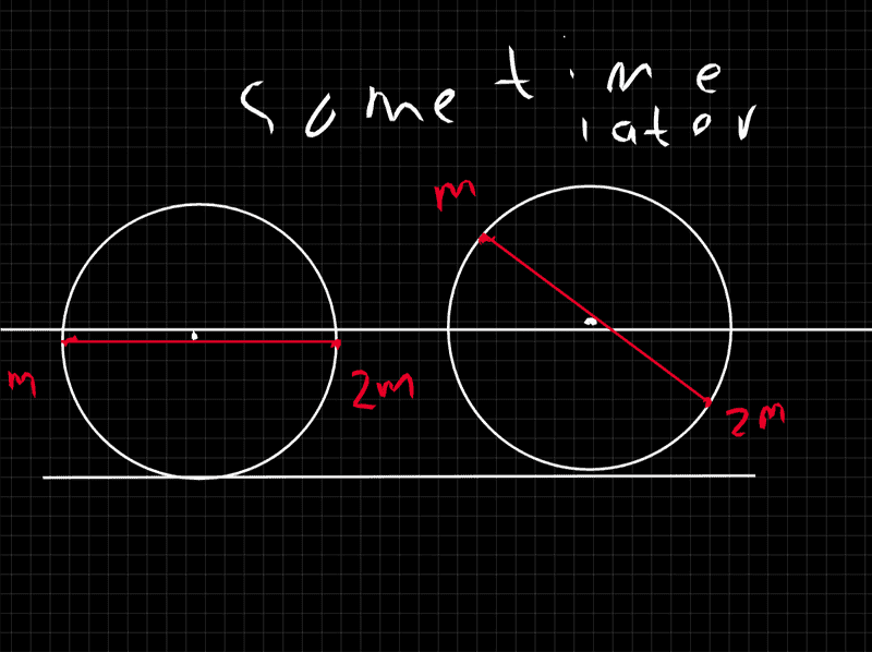

This is how my mind is visualising the motion. According to this diagram the center of mass is indeed in circular motion with respect to the center

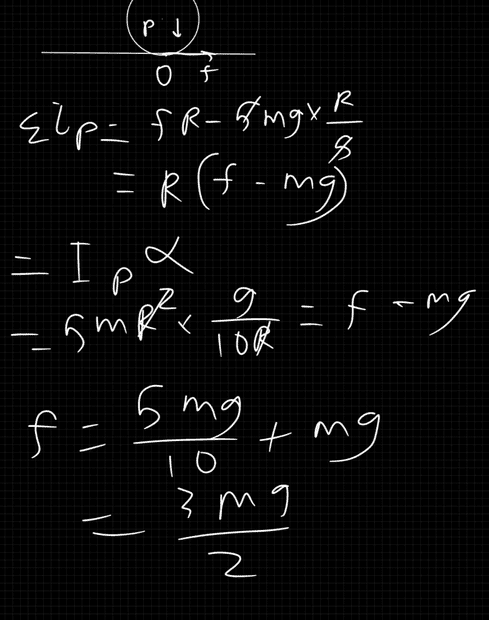

Here is my attempt for finding the frictional force. I have assumed that the center of mass is in circular motion with respect to the geometric center of the ring.
Bad assumption.

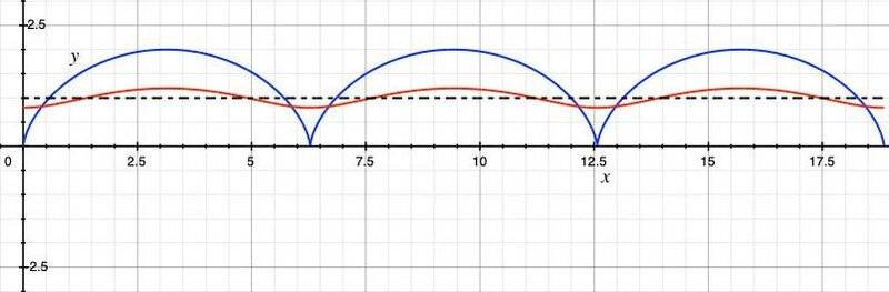

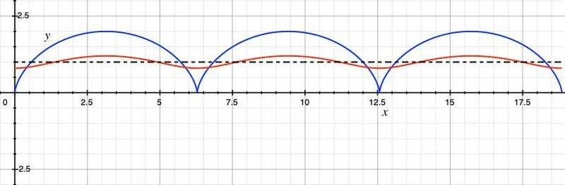

The figure below shows the trajectory of a point on the ring (blue line), the trajectory of the CM (red line) and the trajectory of the center of the ring (dashed black line) assuming that the ring is rolling at constant velocity. This is not the case here because the ring will oscillate back and forth after it is released.
Please don’t post working as images. It is contrary to forum rules for good reasons. Your writing is not completely clear, and it makes it hard for responders to refer to specific equations. If you must post working as images write very clearly and number the equations.
Also, you do not explain where your equations come from.
In your attachment to post #79, you seem to have an equation which has forces equal to ##\alpha R/5##. Is there an m missing?
In the attachment to post #101, what is ##\Sigma lp##? Or is it ##\Sigma \tau p##? Or ##\Sigma \tau_p##?

Please ignore my poor handwriting. What I did was just taking the torques about the center due to friction and due to the weight from com and equated them to Ialpha
