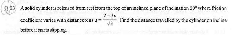

(see attachment)
I am not able to understand the question and build a scenario in my mind. The question asks the distance traveled when the cylinder starts slipping. I can't think of the situation when the cylinder "slips". I am not sure which equations to start with and i suppose this question involves some integration too.

How much friction force is required to prevent slipping?
I am not sure but do i have to make the equations for torque and the forces to find the frictional force?
Yes. Apply Newton's 2nd law for rotation and translation.
Let the mass of cylinder as M, radius R, friction force f, α as angular acceleration, θ as angle of inclination, and a as the linear acceleration, we have
[tex]fR=\frac{MR^2}{2}α[/tex]
Since, the cylinder does not slip, the equation α=a/R is applicable, so
[tex]f=Ma[/tex]
Now,
[tex]Mg\sin(\theta)-f=Ma[/tex]
[tex]Mg\sin(\theta)=2Ma[/tex]
[tex]a=\frac{g\sin(\theta)}{2}[/tex]
Therefore, the friction force required to prevent slipping is
[tex]f=\frac{Mg\sin(\theta)}{2}[/tex]
Is this correct?
Good.
[tex]f=Ma[/tex]
Redo that step and all that follows.
But you're on the right track. Once you have the correct expression for the friction force, ask yourself what minimum value of μ is required to provide that force.
Oops, made a small mistake there. :redface:
The f would be
[tex]f=\frac{Ma}{2}[/tex]
Solving using the same method as before, i get
[tex]f=\frac{Mg\sin(\theta)}{3}[/tex]
Doc Al said:
...ask yourself what minimum value of μ is required to provide that force.
I still can't get the meaning of the problem. Doesn't the cylinder starts slipping the instant it is released or does "slipping" have a different meaning here? :confused:
The f would be
Good.
As long as the surfaces are capable of providing the needed friction force (which you have just calculated), there will be no slipping. But on this surface, the value of μ (and thus the maximum available static friction) decreases with distance down the incline. At some point the surfaces will not be able to provide the needed friction and the cylinder will begin slipping. Find that point.
The f would be
The cylinder starts rolling when released if the static friction is enough. Remember the force of static friction ≤ μ FN (FN is the normal force).
ehild
ehild
Thanks you both for the explanation, i have got the right answer. :smile:
To find that point, i equate the friction force provided by the surface to the friction force required to prevent slipping.
[tex]μN=\frac{Mg\sin(\theta)}{3}[/tex]
Here N is the normal reaction due to the inclined plane and is equal to Mgcos(θ).
[tex]\frac{2-3x}{\sqrt{3}}Mg\cos(\theta)=\frac{Mg\sin(\theta)}{3}[/tex]
Solving, i get
[tex]x=\frac{1}{3}[/tex]
Thanks once again!
Good! :approve:
Here is my attempt at the problem and i am getting an incorrect result ...Kindly check my work and let me know where am i making mistake
Since at the point of slipping maximum static friction acts
[itex]f = μN[/itex]
where [itex]N = Mgcosθ[/itex]
Thus [itex]f =μMgcosθ[/itex]
but at the same time ,
[itex]f = \frac{Ma}{2}[/itex]
So, [itex]\frac{Ma}{2}=μMgcosθ[/itex]
[itex]a=2μgcosθ[/itex]
now θ =60°
[itex]a=μg[/itex]
[itex]μ =\frac{2-3x}{\sqrt3}[/itex]
[itex]a=(\frac{2-3x}{\sqrt3})g[/itex]
Writing [itex]a=v\frac{dv}{dx}[/itex]
[itex]v\frac{dv}{dx}=(\frac{2-3x}{\sqrt3})g[/itex]
[itex]vdv={(\frac{2-3x}{\sqrt3})g}dx[/itex]
[itex]\int_{0}^{v}vdv=\int_{0}^{x}{(\frac{2-3x}{\sqrt3})g}dx[/itex]
[itex]\frac{v^2}{2}=\frac{2}{\sqrt3}gx - \frac{3}{2\sqrt3}g{x^2}[/itex]
Hence ,[itex]v^2=\frac{4}{\sqrt3}gx - \frac{3}{\sqrt3}g{x^2} (1)[/itex]
Now, we will apply Conservation of energy
When the cylinder has moved by a distance x along the incline ,then
Loss in potential energy =Gain in Kinetic energy
Since rolling without slipping occurs,we can put v=ωR and [itex]I = \frac{MR^2}{2}[/itex]
[itex]mgxsinθ = \frac{1}{2}Mv^2 + \frac{1}{2}Iω^2[/itex]
Solving ,we get [itex]v^2=\frac{2}{\sqrt3}gx (2)[/itex]
Equating (1) and (2) we get x=2/3 which is incorrect.
Where am i getting it wrong?
You can not apply conservation of energy.

why can't we apply conservation of energy?? friction is not doing any work since the cylinder rolls without slipping ...energy is definitely conserved till the point cylinder starts to slip
Well, yes, you are right... The energy is conserved.
You used the maximum static friction to calculate the speed. a=2Fs/m, but Fs is not μgsosθ during rolling. It reaches that value only at the end when the cylinder starts to slip.
You can get the acceleration a from the kinematic equations for translation of the CM and rotation about the CM.
ehild

Okay...Then what should I equate 'a' (accelerataion) with ? Kindly let me know how then will i be able to calculate the speed 'v' at distance 'x' .I have showed you the complete working ...
You do not need v really. But if you want it, find the acceleration first and integrate. What equations do you have for the motion of the cylinder?
ehild
For translation motion
[itex]N=Mgcosθ[/itex]
[itex]Mgsinθ - f = Ma[/itex]
For rotational motion
[itex]fR = Iα[/itex]
For rolling without slipping [itex]α = \frac{a}{R}[/itex]
Putting these values , we get
[itex]a=\frac{2}{3}gsinθ[/itex]
Integrating , we get [itex]v^2=\frac{2}{\sqrt3}gx[/itex] which is the same result which we get from applying conservation of energy
What then is the condition mathematically , which we can apply in finding when the cylinder starts to slip ?
Well, a can be determined from conservation of energy. You know a, then you can find the force of static friction. What is it?
ehild

How can we find a from conservation of energy ?
Okay...then we are on the same lines as what has been done earlier by Pranav...i.e equating [itex]\frac{Mgsinθ}{3} =μN[/itex] .Isnt it??
yes, it is. At the brink of slipping, Fs=μN.
As for acceleration, you can find v from conservation of energy, and then you can differentiate... A bit complicated, and has no sense to do it now. The velocity was not needed at all.
ehild
