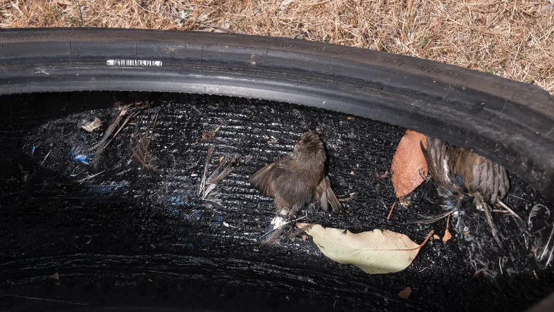

Four wrens stuck and killed by deadly goo inside a tyre
I tried searching for a solution to this problem, but other than “rubber doesn’t melt”, or “the rubber belts in my old cassette player turned to goo”, I couldn’t find find any explanation as to why the rubber inside an old tyre has turned to deadly goo.
Question
I’d like to know how and why this happened – the chemistry behind the thing, and whether this is aberrant behaviour for an old tyre, or typical.

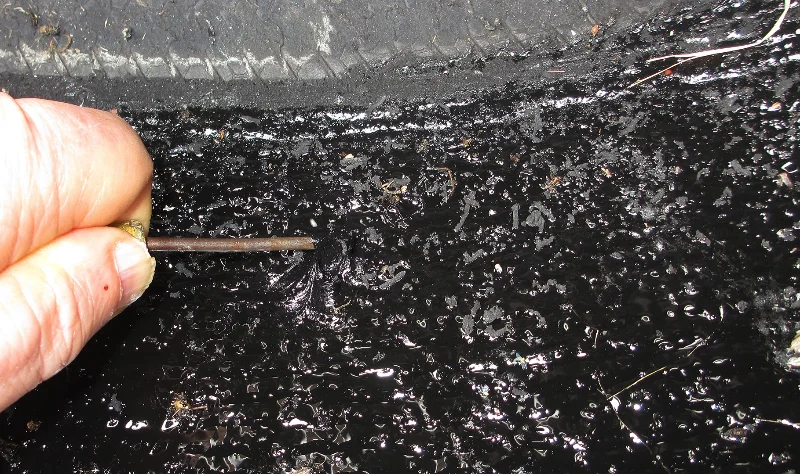

The goo is bad stuff. Four tiny wrens landed on it while exploring, and couldn't get out. I stuck in a small screwdriver, and I reckon I applied 500gms force to stretch the stuff 2 cm. It's also extremely sticky. Even a light touch with a finger will coat the finger. Turpentine dissolves the goo.
See attachments showing the dead wrens and the screwdriver.

The tyre was good quality, costing around $330 each in Australia, and was on the car since new. I kept the flat tyre as I use them to make steps in outdoor settings. I left this particular tyre laying around the back yard for 9 months, horizontally, throughout our winter here in Tasmania (5-15º), and now we’re into summer (10-25º). In summer, it's in the mid-afternoon sun 4-5 hours a day, so it probably heated up to ~40º. For eight months it had a pool of water inside, all the way around, due to winter/spring rain. Recently, the water dried up, but I hadn’t noticed.
Dead Wrens
But I did take notice when I went to move the tyre a few days ago. I was shocked to find four dead Blue Wrens inside, stuck to a black goo. The whole of this year’s family had been killed – two adults and two young ones. They landed on the goo, and couldn’t extricate themselves. The wrens have been around for 30 years, generation after generation, because we feed them grated parmesan cheese. So it’s a bit of an emotional loss for us.
Horror Tyre
This tyre has turned deadly. It will have to be buried or taken to the recycle centre. I want to know why it’s turned deadly as I’ve never seen any other tyre do this. I have four other tyres laying around at the moment, all different makes and sizes, but they look normal.

Thermal chemical decomposition of the rubber.

Possible, but still a bit strange - it wasn't exposed to temperatures other than it would be on the car, and somehow I don't think goo inside the tyre is something desired.
Is it possible your old tires featured ContiSeal?
ContiSeal is a technology developed by Continental designed to seal a damaged tire tread. In case of penetration by foreign objects such as nails, there is no need for immediate roadside tire changes, and holes remain sealed even if the puncturing object becomes dislodged. ContiSeal is a sticky, viscous sealant layer. It is applied to the inside of the tire in the tread area. ContiSeal seals 80% of all tire punctures and therefore reduces the risk of flat tires. ContiSeal tires are marked clearly with a symbol on the sidewall and are compatible with all commonly available rims. ContiSeal and other technologies apply to selected product range.
(https://www.continental-tires.com/products/car/tires/contisportcontact-5/)

Contiseal is a very promising explanation. Three of the original tyres are still on the car, but I'd have to get them off the rim to find out if Contiseal is inside. I think I'll show the goo to the fella who sold me the new tyre and ask him about it.
P.S. I doubt that any explanation featuring rubber decomposition is a goer, but you never know.
P.P.S. I just had a look at the sidewall, and there it is – the word "Contiseal" built into the rubber. Good on ya, Renormalize, for the Contiseal suggestion. But it looks like a should have asked this question in a tyre forum, not a chemical forum.
If anyone has a better explanation than Contiseal, please reply.

Interesting. I have read about similar technology were in the rubber there were tiny sealed ampoules with glue, they were intended to tear open when the rubber is breaking (for any reason) and to seal out the hole. Sounds like a safer and more convenient approach (both for wrens and users).
